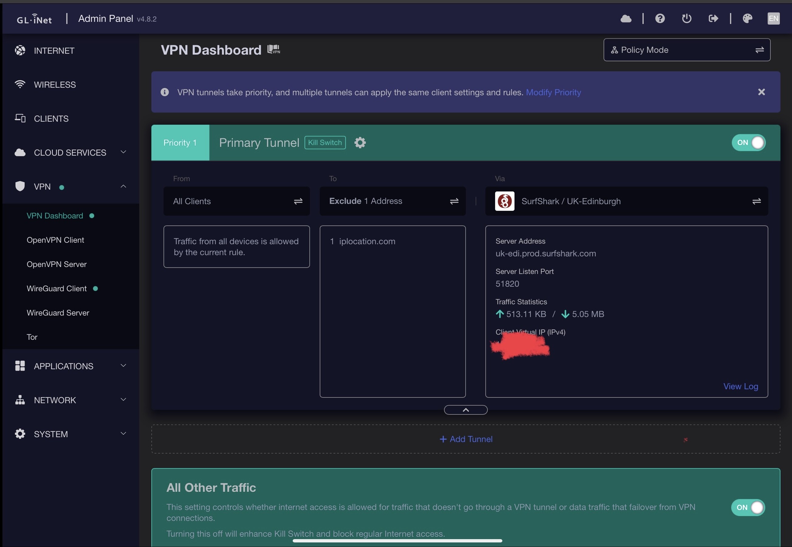

The Exclude IP address on the flit 3 never got it to works with a freshI install on a flit 2 ot worked until something is changed eg different location then it fails, on GL-AXT1800 Slate AX firmware 4.8.2 the same worked first time any change it fails and all domains go through the Tunnel, picture below worked perfectly first time.

Tried it for 2 hours never worked on the the Flint 3 the ip address problem.
What are the IP addresses?
The actual IP address of your APPs/Web page access may be different from the VPN policy configuration or not comprehensive enough, because many service providers have CDN servers or redirect servers. You can use tcpdump to capture the actual IP address you are accessing.
Thanks Bruce but the Flint 2 with the latest firmware works every time, just the Flint 3 has the problem and i believe the GL-AXT1800 Slate AX has problems but I want to check that again.
May I know if there are any VPN problems with Flint3 and Slate AX?
