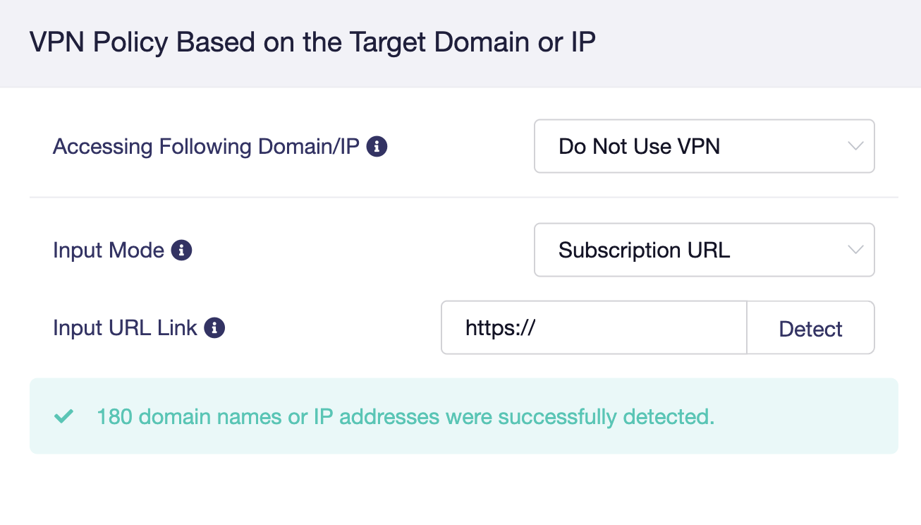

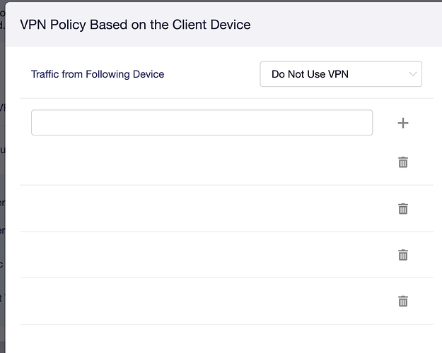

I've tried the below two policies so far (both work):

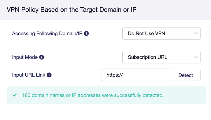

  1. "VPN Policy Based on the Target Domain or IP" — I whitelisted all the VPN relay IPs, such that the (A) devices can connect directly to them

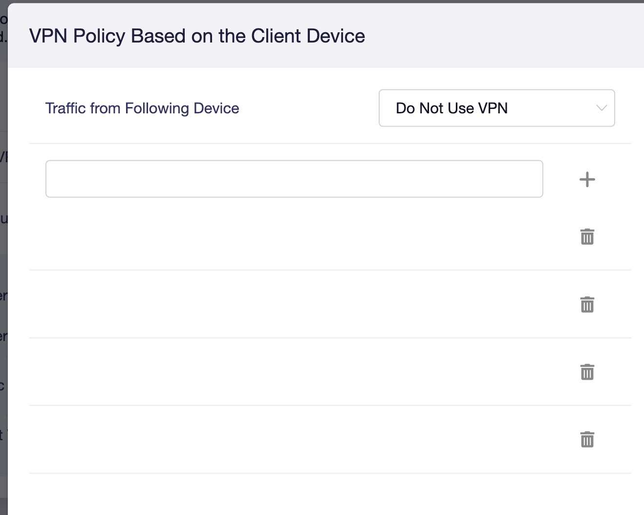

  1. "Based on the Client Device" — I whitelisted all (A) devices (the ones with software VPN)

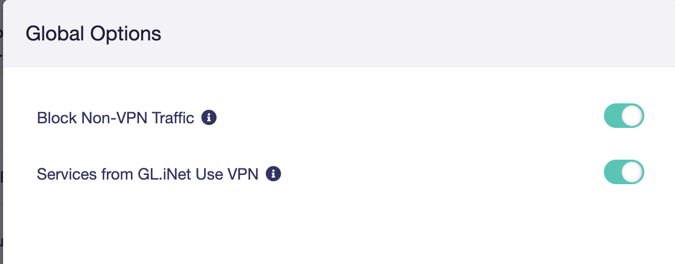

However, once I enable the kill switch ("Block Non-VPN Traffic"), the (A) devices will no longer be able connect to their VPN relays.
Thus, I have to keep the kill switch disabled, which makes me quite uncomfortable.

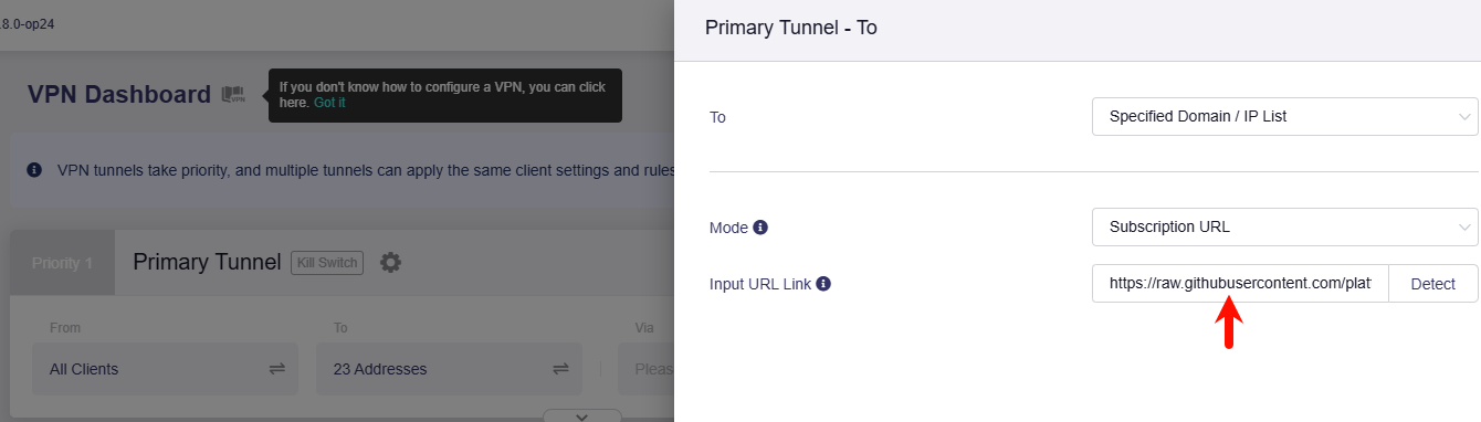

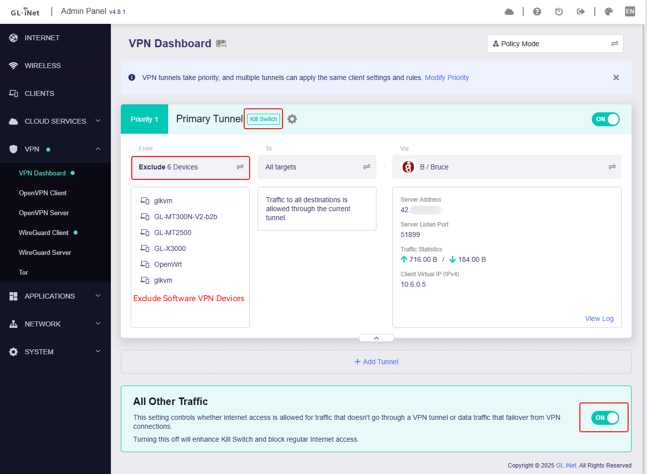

After upgrading the firmware to v4.8.0, can it achieve your needs?
Hi Bruce, I just installed it and played around with it. Are these the right settings to achieve the behavior that I described in my OP?
Also, I'm still curious how it was handled pre-v4.8.0, i.e., in what situations leaks could occur. Thank you.

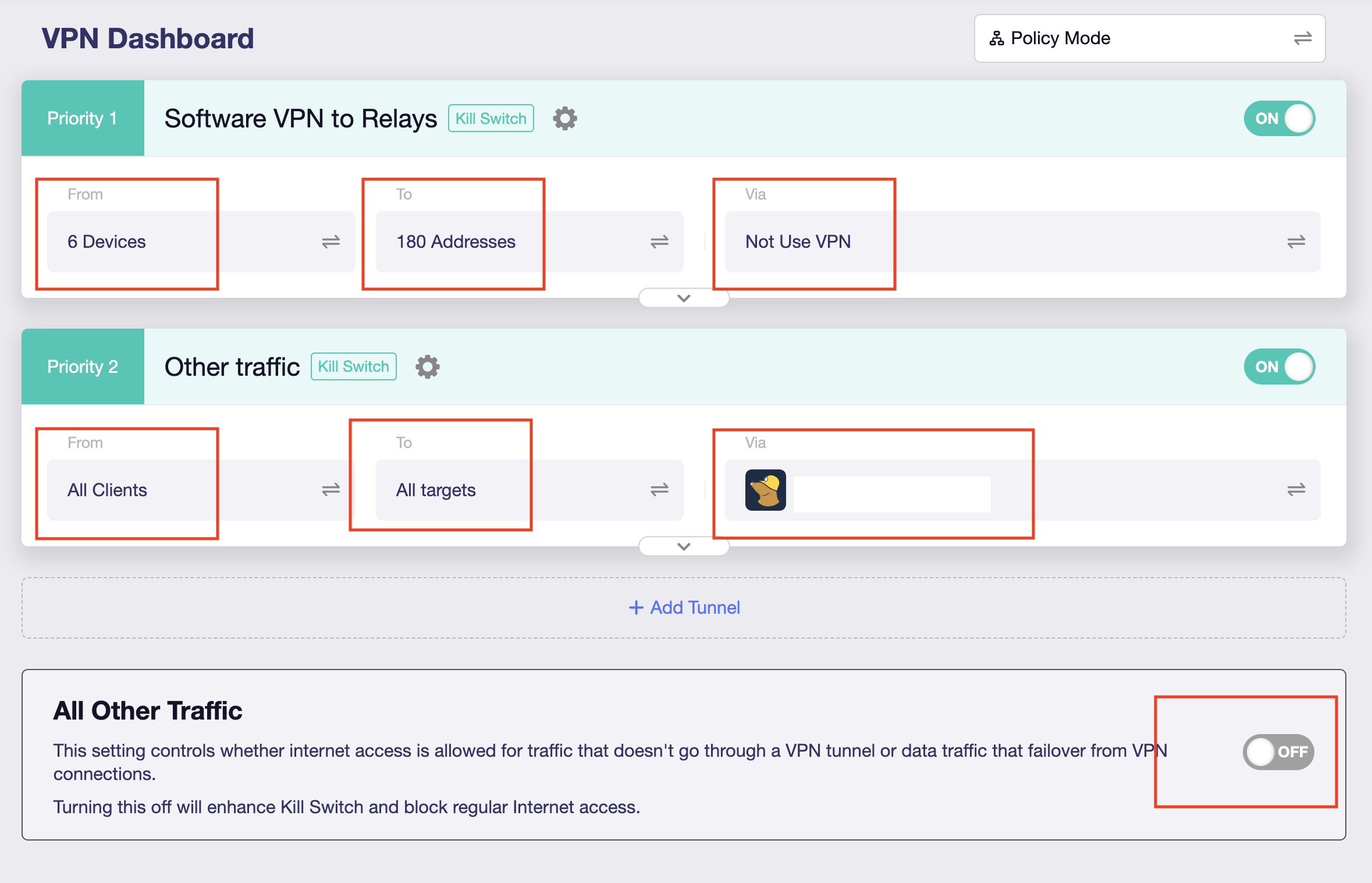

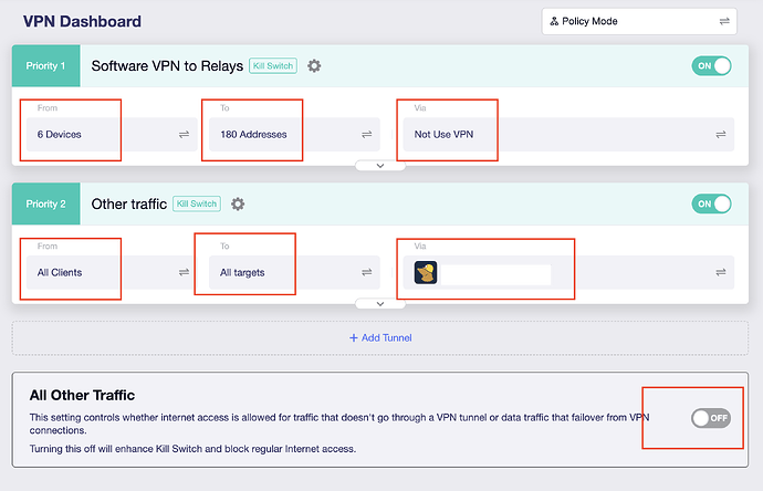

According to your needs the Devices A (Software VPN to relays) do not go to VPN, and combined with the screenshots of Tunnel 1 & 2 above, why not set it like this:
  1. Devices A will not go to VPN and go to WAN via All Other Traffic rule.
  2. Other clients will go to VPN, and Kill Switch enabled.
I think you have mentioned the possible leak scenarios before
I prefer my approach because it massively reduces the risk of Software VPN leaks ... because the clients can only reach the ~180 Wireguard relays directly, while all other traffic would go through the default VPN on the Flint.

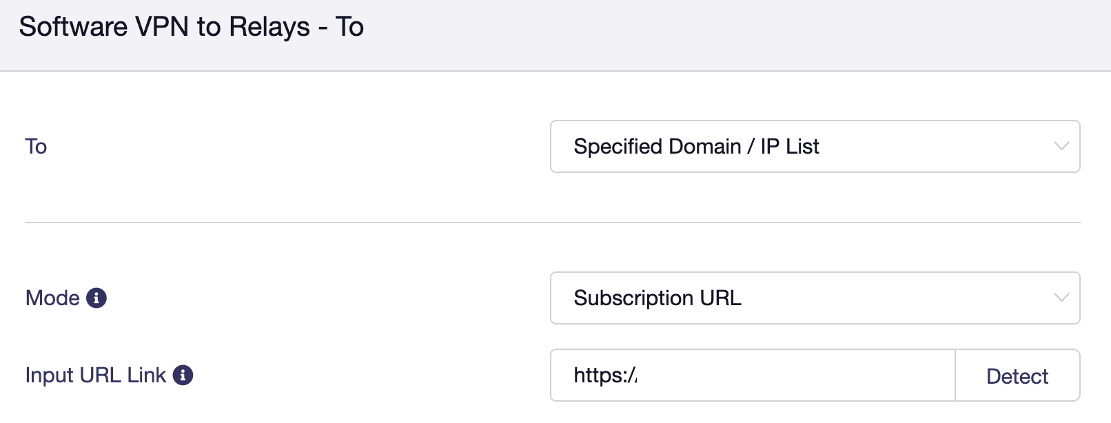

I automatically update the input list of relays multiple times per day, so it should be pretty bullet proof.
Is there a way to have the Flint load the list of relays ("Input URL link") more than once daily, to catch any potential changes faster? E.g., to avoid scenarios where clients create their own Wireguard tunnel inside the Flint's VPN tunnel, because the Flint hasn't pulled my latest relay list, yet.
Or worse (but unlikely to become a real world issue), that the VPN provider turns off relays and returns the corresponding IPs, which would make them unsafe to connect to directly.
Sure, you know needs better than me, configure them according to your ideas.
Subscription links are updated once a day 3:00 by default.
You can find this script to change it according to the cycle you want:
/etc/gl_crontabs/crontabs.d/update_vpn_url
