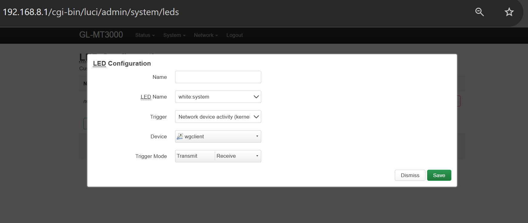

How to 1)while light stable on vpn connect and 2)blue light stable on internet?
Beryl AX: I tried multiple combinations for many hours, but couldnt achieve this:
  1. I want blue steady ONLY on internet connect.
  2. I want white steady ONLY on VPN connect.
    if not possible, Reverse could also work.
Obviously, I want to judge without opening the admin panel if 1) Internet is accessible 2) VPN is connected. I tried below, but even for this I have to login every time router powers up actually :frowning:
Request someone to help please. I need this badly.
GL-MT3000 Beryl AX: what version do you used?
I will try to reproduce your problem and try to find a solution.
