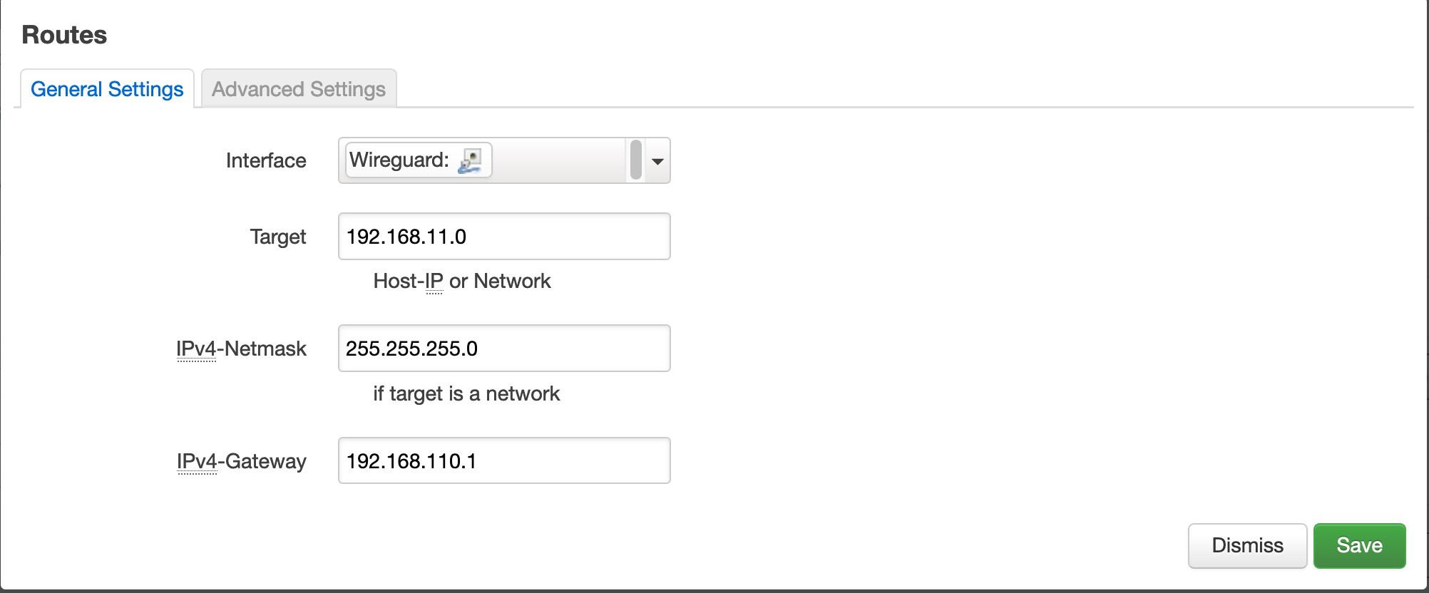

I would like to add a static route to a wireguard interface.
I tried to do it via Luci, but the first problem is that the wg0 interface does not show up as an interface in Luci.
In another thread I have read that it needs to be added manually. So I created an interface manually.
But when I then create a static route with that interface, the route does not show up in the routing table.
