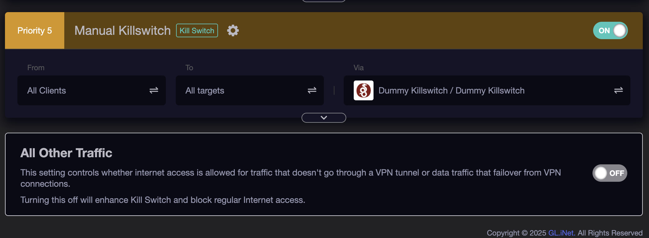

I just started using below workaround and the rogue DNS queries have stopped. Maybe it also fixes your problem @tunnlp

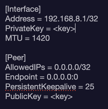

Workaround: add an invalid Wireguard peer (IP 0.0.0.0 or so) as the bottom rule.

Your solution looks interesting. It’s just backstop to prevent it getting to the wan? Very clever! I think that’s worth a try.

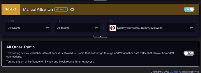

I just tried this, setting a dummy kill switch, enabling this and disabling my wireguard tunnel… However this doesn’t seem to work. I am still able to access the internet when connected to a VPN on the client :frowning:
Don't you mean disconnected? I would expect to be able to ultimately access the WAN when connected thru a VPN endpoint.
You also enabled the invalid dummy tunnel? And can still connect? Idk. Sounds bad.
Just noticed that even with the dummy tunnel, a handful of DNS queries still leaked (4 since I enabled it … much better than hundreds, but still not good).
I noticed previously that leaks occur when I toggle rules above the last rule OFF/ON, but seems they can also occur in the absence of user action.
