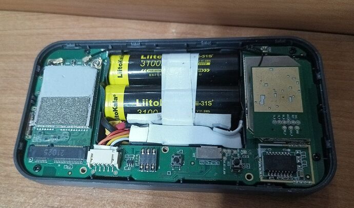

Checking in 1.5 years later – my replacement 605065-based battery pack is still working and keeping the mudi alive and kicking.

If you have a photo of the battery you replaced and it’s working properly, please attach it here; I’m sure it will be helpful to other users.

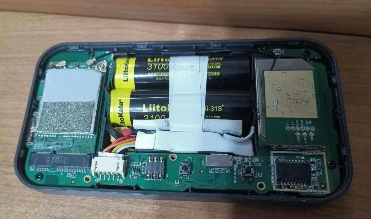

Hello! I managed to separate the two swollen pouch cells from the charging controller and spot-weld two 18650 cells in parallel in their place. They fit perfectly inside the battery compartment, and everything is working great so far.
