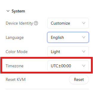

Currently, there's no direct way to modify the time, but you can adjust the time zone in the KVM console to match your local time.

I used this menu as shown above by Flora72. And to account for daylight savings, pick a country 1 hour to the right of you - so for London, pick Paris, etc.
This may only need doing twice a year (shift back to your home country during non-summer time) and if there’s a new firmware by then it may only need doing once/twice, ever.
