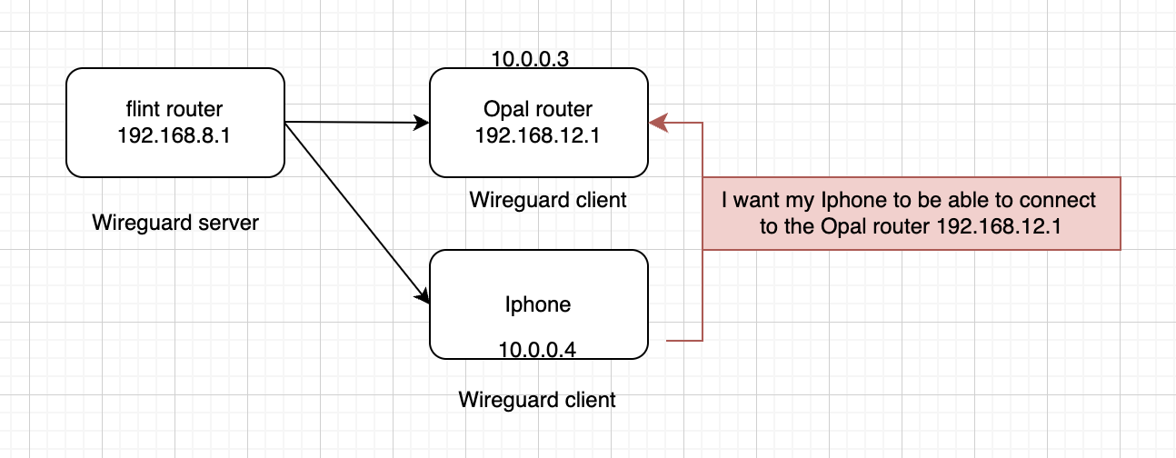

In my house, I have a GL.iNet Flint router with the address 192.168.8.1. I configured a WireGuard server on it. I connected to the VPN from my phone and from another GL.iNet Opal router that have the address 192.168.12.1. Everything works well. What I want now is to be able to access my Opal router from my phone when I am connected to the VPN. basicly my iphone and opal routeur is connected the Flint router wirguard server .
this is a diagram of what I want to establis

I already have that option enabled, but I can't connect to the Opal router from my iPhone. I believe this option allows the WireGuard client to connect to the WireGuard server router, and it works fine. However, as I mentioned, I want to connect the two WireGuard clients directly.
And also I have already added a rule in Flint server with : Targer address : 192.168.12.0/24 and Gatway 10.0.0.4

from my phone I can acess the Flint router without any issue (10.0.0.1 or 192.168.8.1), but as I said i want to access th webUI of the Opal router from my phone
Please modify the 'Forward' as 'accept'.
Great it’s working now, thank you
