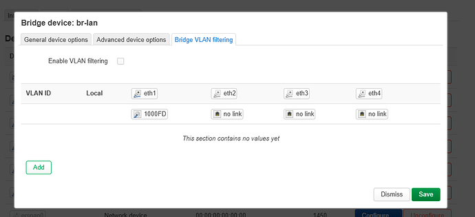

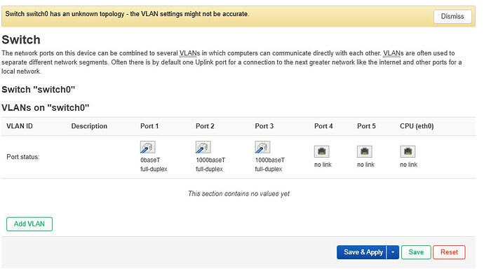

Try looking for it in LuCI:
  1. Network > Interfaces > Devices > br-lan > Bridge VLAN filtering
  2. Network > Switch

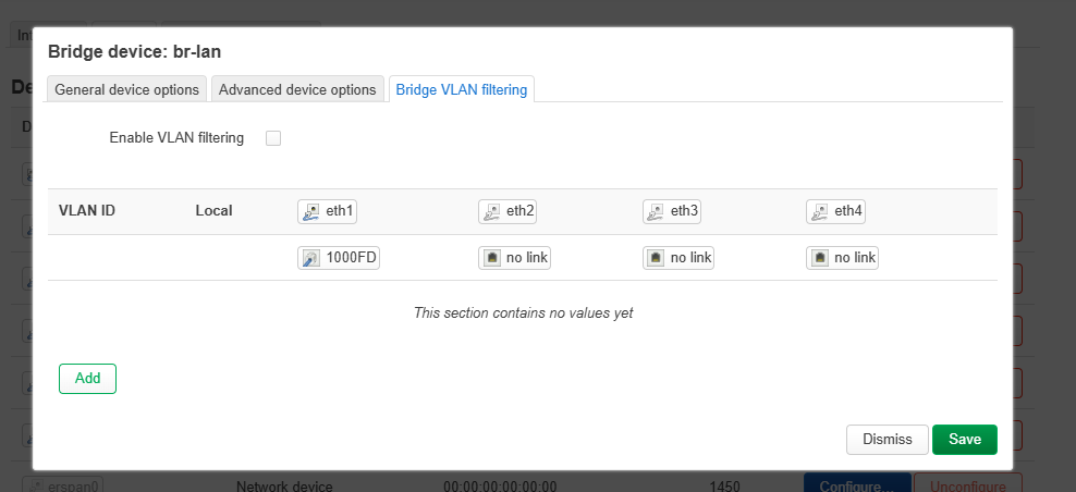

Please manually upgrade to the v4.8.3 (beta) for AX1800 first:
You can find the AX1800 VLAN configuration here:
Luci > Network > Interfaces >Devices > br-lan > Configure... > Bridge VLAN filtering
