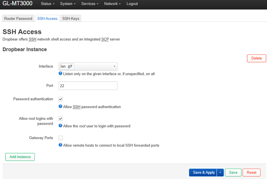

Enable SSH and SCP access in the GL.iNet Panel
  1. Access the router’s web interface (usually 192.168.8.1).
  2. Go to System -> Advanced Settings (this will open the LuCI interface).
  3. Log in using the same router password, but with the username root.
  4. Go to System -> Administration.
  5. Enable SSH access on port 22.
  6. Make sure the LAN interface is selected under SSH Access.

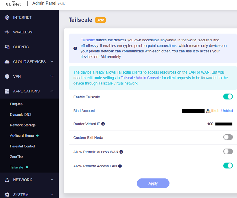

Disable the Tailscale service on the router

Enable the Tailscale service on the router
And that’s it!
Could you advise on making the side toggle turning tailscale on and off ?
I didn't get around to researching this, but there's something about it here: https://gist.github.com/jesserockz/f6e7dc277c8f850dd3d353d41138bb4b
