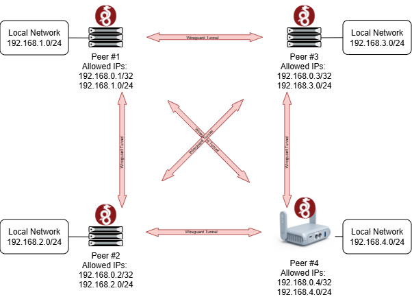

I’ve bought a Beryl AX (GL-MT3000) router (running v4.8.1) and would like to know the best way to add it to my existing Wireguard mesh network?
Simplified diagram of what I’m trying to achieve:
Peers #1/2/3 already exist and I have full Wireguard mesh routing working (including access to their local networks), but I am having trouble configuring my GL.iNET router to join the mesh...

As per the diagram I posted, I want a single Wireguard interface with all three peers associated with it. If I set it up using native Wireguard it would look like this:
[Interface]
Address = 192.168.0.4/32
ListenPort = ...
PrivateKey = ...
[Peer]
PublicKey = ...
Endpoint = peer1.mydomain:port
AllowedIPs = 192.168.0.1/32, 192.168.1.0/24
[Peer]
PublicKey = ...
Endpoint = peer2.mydomain:port
AllowedIPs = 192.168.0.2/32, 192.168.2.0/24
[Peer]
PublicKey = ...
Endpoint = peer3.mydomain:port
AllowedIPs = 192.168.0.3/32, 192.168.3.0/24
What is really needed if for GL.iNET to support multiple peers in the WG Client definition.
