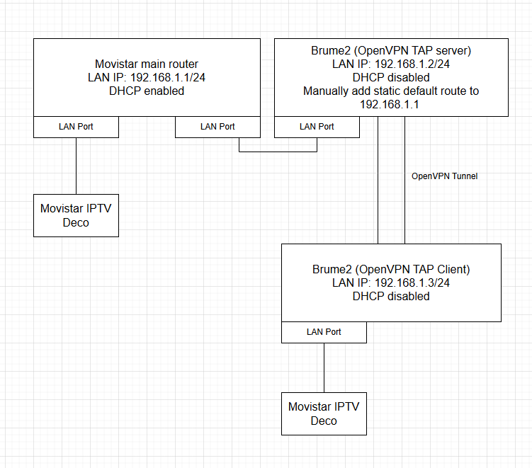

WireGuard does not support proxying Layer 2 traffic (DHCP/IGMP/multicast).
Please try using OpenVPN TAP mode.
Topology will be like below:
@mortneff Tailscale is great for Plex, surf the web and even stream videos and other stuff, but an iptv box is different.
@will.qiu I’ll definetly try that and see how it goes. I assume the cable goes from the main router [lan port] to the Brume2-server [wan port]. Thanks for the advice. Will report back soon.
There is no typo — it is indeed LAN port to LAN port.
This wiring method is a bit unusual, but useful for your specific case.
