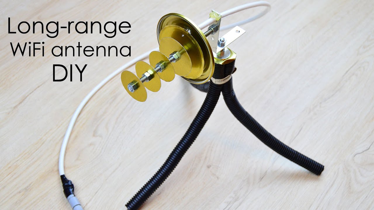

Can make a great deal of difference. If you are particularly good with RF cables you can try something like this for extreme range -
Many people make their own -
I have achieved range over 1 mile with 20 foot pole and external antennas with GL products.
