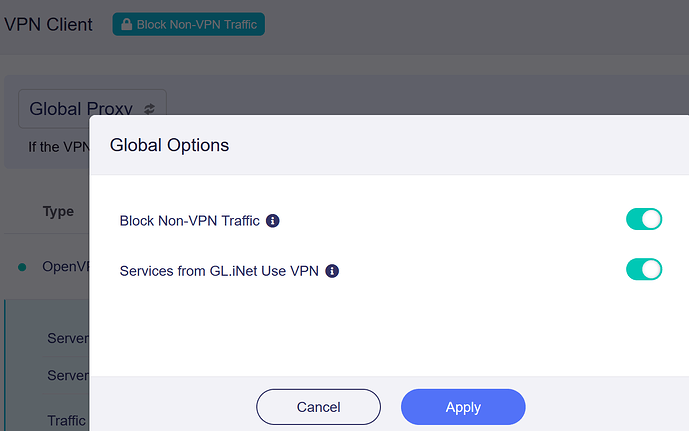

I want to use NordVPN and the Flint 2 Router. All devices that connect to the Flint Router should only use the VPN. I already enabled Block non vpn traffic.
But the DNS settings are confusing. Do I have to to set up the DNS manually from the Nord website or should I leave it as it is? It is confusing, because in the docs of GL.iNet it states the following: "Automatic, use the gateway of the parent router." I don't want that in any case my real dns is exposed and used by the devices connected to the router. This includes if the VPN connection drops.
Can someone explain what the right settings are for this case? I uploaded two screenshots. One is the settings I applied to the VPN section and the other one is the DNS settings page. The DNS from repeater shows the local IP adress of my real router.
Again I am really confused and I hope that someone can explain what the correct (no possible leak of my actual DNS) settings are for my case.
I would like to finish the setup of the router today. It would be amazing if someone could give me an answer. Thank you!
Usually the DNS settings are taken from your wireguard / openvpn config. I believe the settings your are looking at are the upstream DNS settings which are not what your VPN will be using.
Ensure you are using global proxy mode (from VPN dashboard)
This will then force all clients via the tunnel. You have blocked non wan So that should stop any device connecting to WAN even when the VPN gets disabled. This is different to a killswitch as the killswitch is only on when the tunnel up (you haven't turned off the VPN client) but again, this seems to be the behaviour you want as it will ensure everything is killed regardless.
The allow custom DNS VPN isn't needed here either, so you can keep that toggled off.
Now just connect your clients to your flint 2 and visit a site like ipleak.net - here you can see your clients external VPN IP address, ensure its reporting correctly. It will also list the DNS further down the page and they should be reporting the same country region as your VPN WAN IP
You can also test the DNS by visiting dnsleaktest.com - this will then report your DNS servers too. Usually the VPN WAN IP and the DNS would match.

Override DNS settings of all clients -> It will intercept plain (!) DNS, so UDP 53, and will replace the server by the router. So if your PC has the setting of 8.8.8.8 for DNS, the request won't reach the Google server but only the router - which will do whatever the router is configured to do.
That's usually what you want.
And in this case, the router is configured as a VPN client which (ideally) points to the VPN server IP as the DNS resolver. So yes, the idea is to force the client (ex. Laptop) to use the router’s DNS and not its own whether set by browser or even DNS software installed (ex. corporate).

Unfortunately if you don't use "Override DNS Settings for all Clients" then the DNS that the router uses will be down to whatever NordVPN has configured. In a normal WireGuard situation, it would just use whatever is in the config file, but in your case NordVPN's DNS may take precedence.
The "Block Non-VPN Traffic" is just protection for all internet traffic (incl. DNS). If the VPN tunnel isn't established, you will get no internet. There is no way for DNS to leak. Whatever DNS server is used will be resolved at the server side of the VPN tunnel (in your case, at the NordVPN server).
Automatic will either use the client device's VPN servers or the WireGuard VPN's DNS servers. But, again, in your case you don't have your own WireGuard server. You're using NordVPN, so it will be whatever their DNS servers are.
