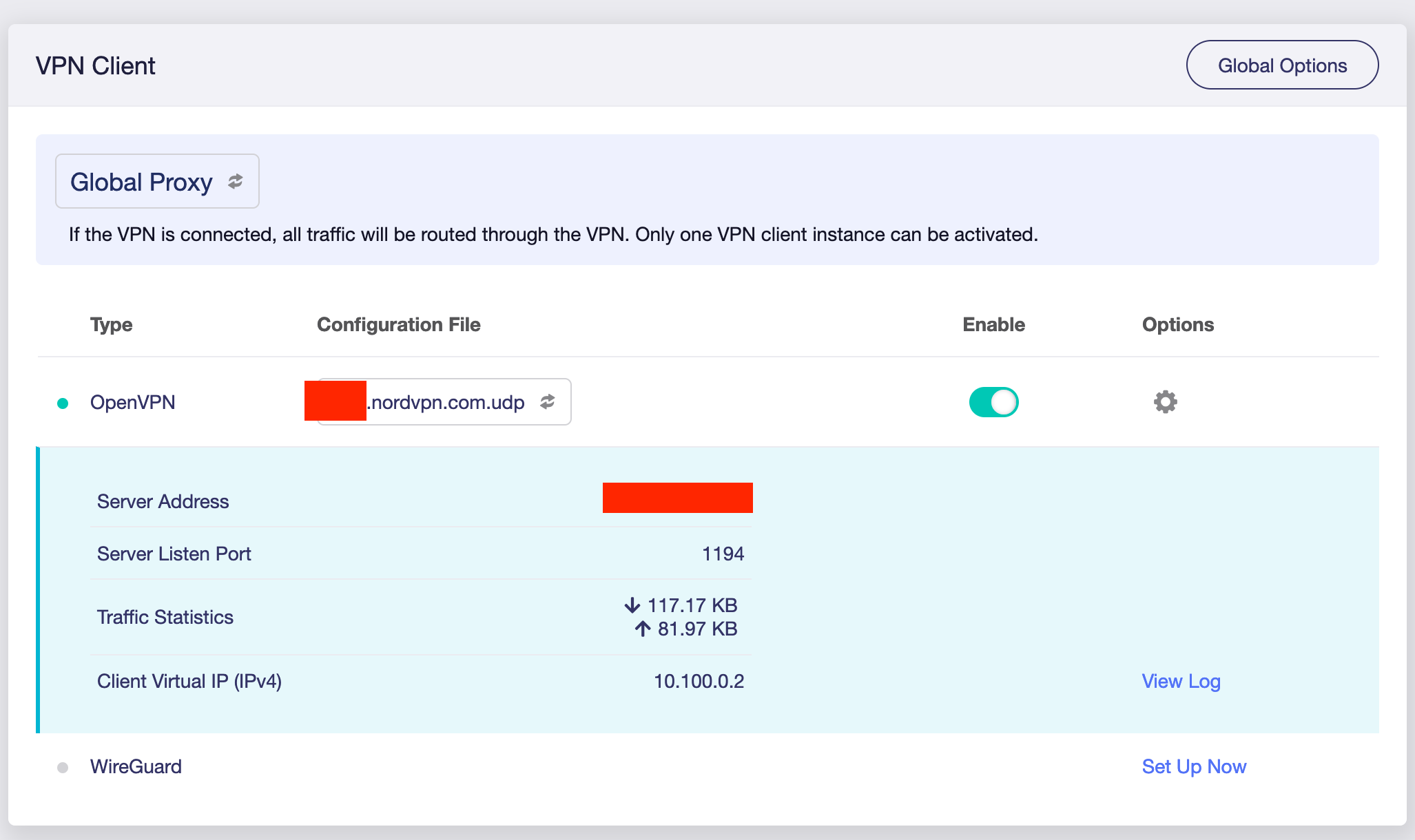

However, when I connect to another VPN using OpenVPN through the router, the camera becomes accessible from the outside, even though the rules I mentioned are enabled. When I disable OpenVPN, the rules work as intended. How can I fix this issue? My software version is v4.6.2.

My configuration is actually working, but when I enable OpenVPN, the rule is applied, but I can still access the camera from the internet. It seems that OpenVPN is causing something to go wrong.

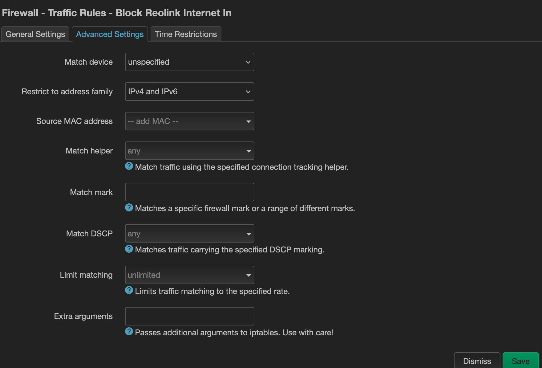

Your second image needs change.
Src zone need to be lan and dest zone wan and also wgclient so you might need 2 rules.

I would like to mention that I restarted OpenVPN with it enabled during these operations. When I disable OpenVPN, the camera loses access to the internet. If I enable OpenVPN again and run the command iptables -I FORWARD -s 192.168.2.105 -o eth1 -j REJECT in the terminal, the camera becomes inaccessible from the internet whether OpenVPN is enabled or disabled. In other words, the command you recommended works correctly in a strange way, but only until the system is restarted. Thank you for your attention, do you have any suggestions?
do you confirm if the router restart (or OpenVPN Client restart), the situation about the camera available to access to the Internet, does the camera Internet via the WAN interface or the OpenVPN Client interface?
If it goes to OpenVPN, try adding this one and leave that eth1:
iptables -I FORWARD -s 192.168.2.105 -o ovpnclient -j REJECT

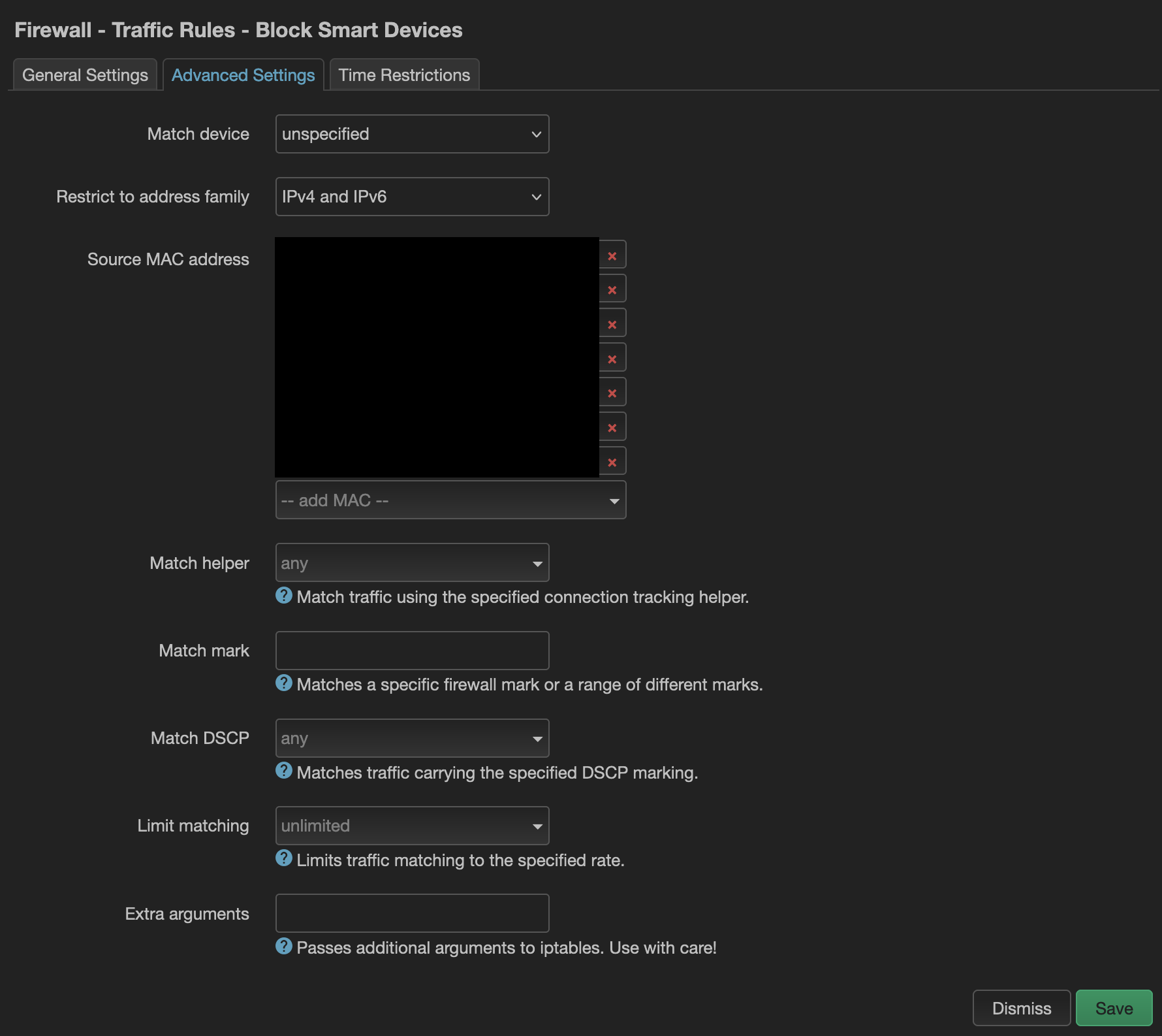

This is how I configured to block my smart devices on LUCI's firewall configuration page:
General Settings:
Advanced Settings:
I configured it by MAC since it's much easier, in case the IP address were to change for whatever reason.

  • When I apply the iptables rule and the OpenVPN Client is ON, the camera continues to access the internet. When the OpenVPN Client is OFF, the camera's internet access is blocked.
  • The IP camera is accessing the internet via the WAN interface.
