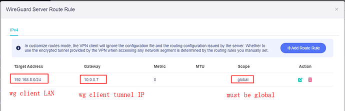

  • WG client:
  1. VPN Dashboard - turn on “Allow Remote Access LAN”
  • WG server:
  1. VPN Dashboard - Route Rule
    Add a route rule for traffic to the wgclient LAN via the wg client tunnel IP. Please note the red notes.
  1. Then toggle wg server(off and on).

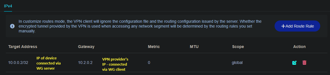

I am trying to do the same, but these instructions are not working for me. Here is my current config:
VPN Server
VPN Cascading - On
IP of connected device - 10.0.0.2
VPN Client
Remote Access LAN - On
IP Masquerading - On
MTU - 142
Customized Routing Rules
Client Virtual IP - 10.2.0.2
I think I have followed the instructions exactly, but the device connected via WG-server still cannot access the internet. What am I doing wrong?

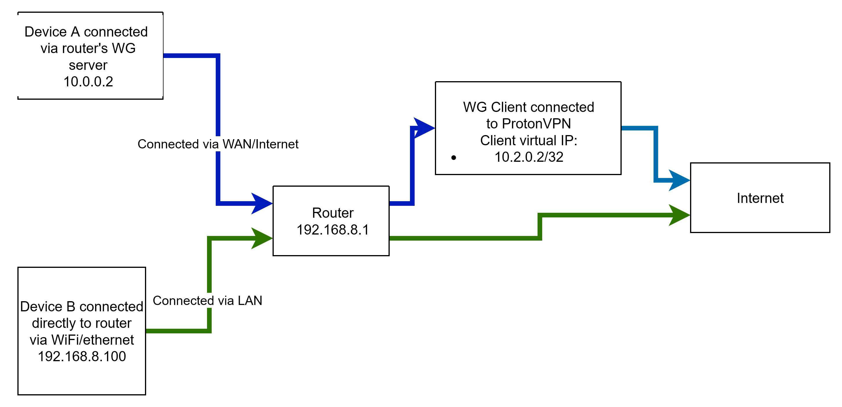

These are two different subnets. Set your WG 'server' to 10.0.0.1/24 .The client would be 10.0.0.2/32. If I'm mistaken in your intent please draw a topology & note the expected flow, IPs, VPN tunnels/IPs.

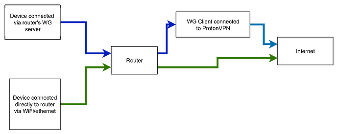

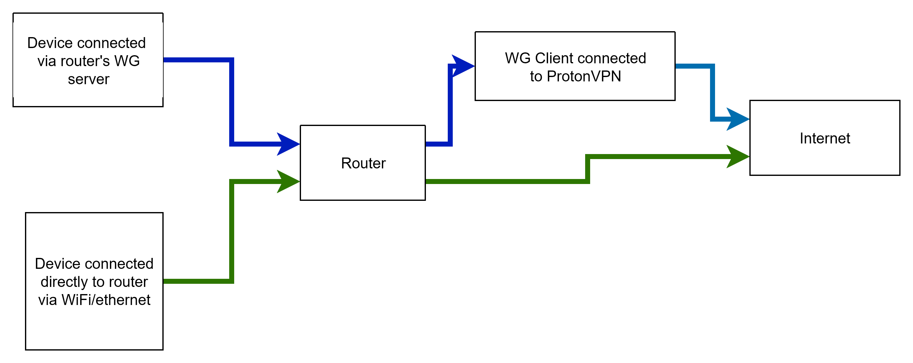

This is what I am hoping to achieve

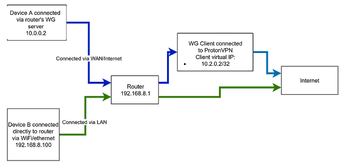

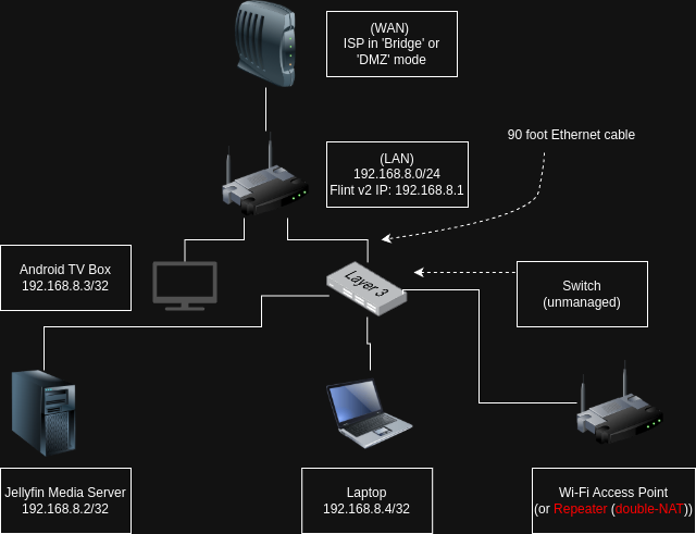

Is 'Device connected by router's WG server' to be a client device coming in from the WAN/Internet into your router/LAN or is it already apart of your LAN like the 'Device connected direct to router via Wi-Fi/ethernet'? You should really put all device host names, IPs, including the VPN ones, on your diagram. Here's an (non-VPN) example:
If it is to come into your LAN via the WG server you're looking to set up on the router
  • a 'WG Client' (Proton VPN)
  • a 'WG Server'
  • enable 'VPN Cascading'
  • set the routes as shown above by @hansome
This assumes you are not using firmware version 4.8.x. That version has different steps. Instead of using 'VPN Cascading' there is 'Policy Mode' & WG Server -> Route Rules.
Verison 4.8.x:
Yes, “Device connected by router's WG server” is coming in via WAN/Internet into the router. It is not inside the LAN. I have set up the router (running latest 4.7 stable) to what I think matches hansome’s settings, but Device A, the one connected to the WG Server via the internet is unable to access the LAN or the internet as soon as the server route rule is set.
