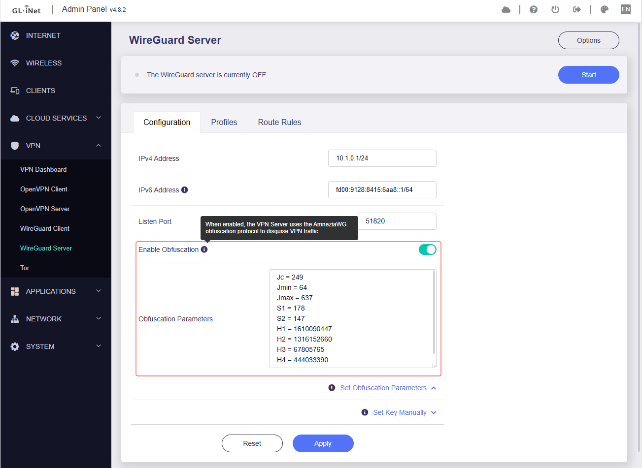

If the GL firmware supports AmneziaWG (including server and client), VPN probably be connected?
We released a beta firmware to test the new feature AmneziaWG in a small range, currently available for the Beryl AX/MT3000.
Warm reminder: as it is a test firmware, there may be some instability, please do not use it in the working environment.
Now you can use AmneziaWG to make your VPN connection more robust using AmneziaWG!
Please obtain the test firmware and report the issue from following thread:
  1. You can manually export profiles with obfuscation protocols in AmneziaWG and upload them to your router manually.
  2. If you have two Beryl AX/MT3000s (one for WG server and one for WG client), you can enable "Obfuscation" on the WG server router and generate a new profile with Obfuscation Parameters, and import to WG client router to experience this advanced feature:
