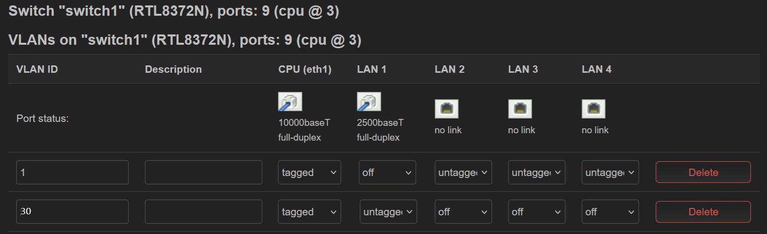

Can you go to Luci > Network > Switch, then dismiss the warning, then make sure VLAN20 is untagged on LAN1 (which is actually LAN4 on the router) and is the only VLAN untagged on LAN1?
That's your problem. Change VLAN1 LAN1 to "off".
well, that pc cannot get an IP now. here is what I have now

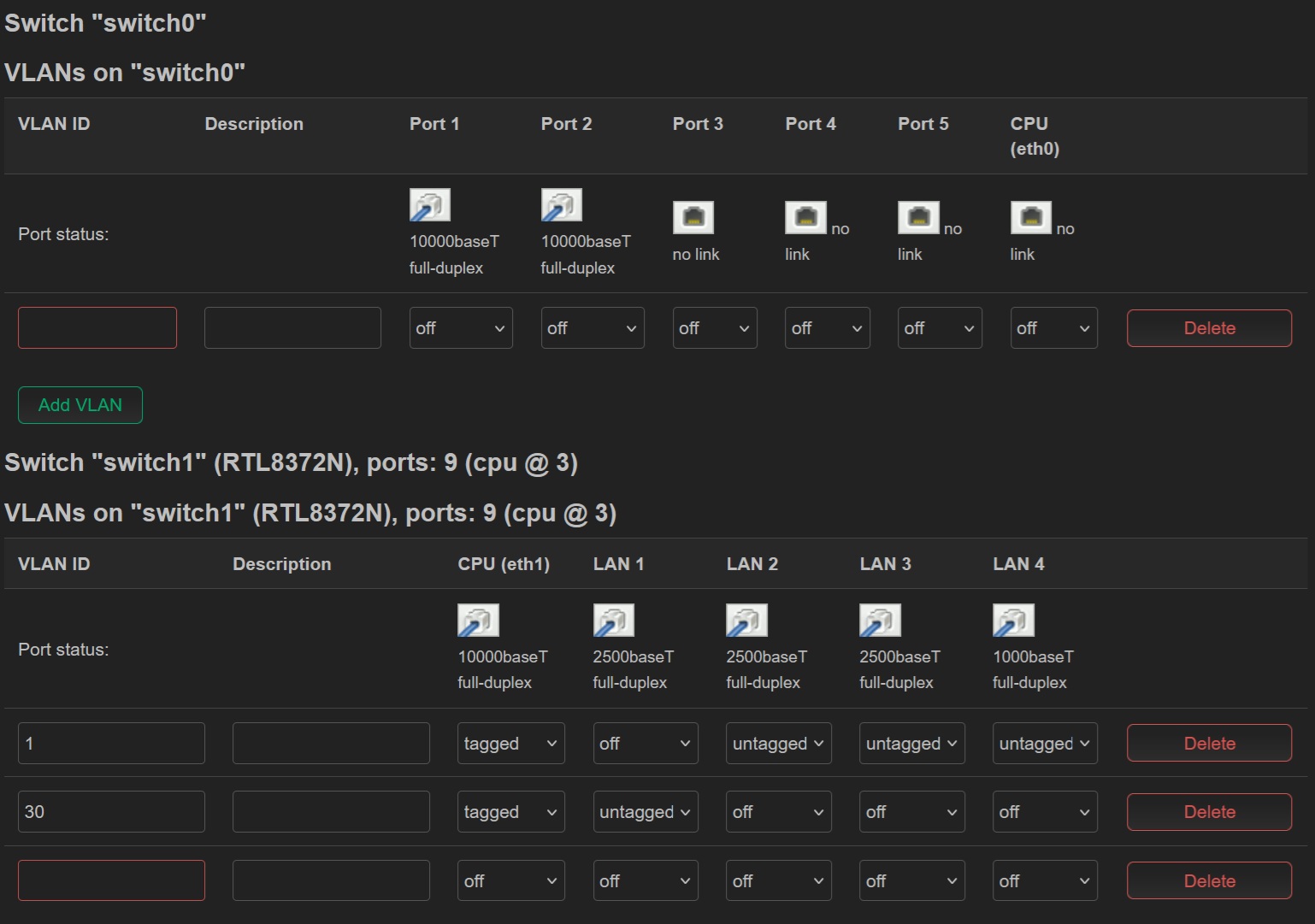

No problem. So after running that script, does your switch settings look like this?
But you're not getting an IP on LAN4?

I got it working, but there’s a damn weird problem with this router.
  1. If I use “uci set network.vlan_lan.ports='3t 5ut 6ut 7ut'“ both LAN & GUESTLAN become inaccessible from hardwired devices.
  2. If I use “uci set network.vlan_lan.ports='3t 5 6 7'“ then LAN is OK but GUESTLAN PC not receiving an IP.
  3. In both scenarios the solution is login from a wireless device and delete the last empty VLAN line in the Switch settings that appears after the script

  1. the blank line came from a backup. not sure how it got there but every time I reload saved backup that line comes with it. deleted it and then made another backup wo the line.
    surprisingly everything worked with that extra line, but without VLAN30
  2. after running the script, even without the blank VLAN line on the page above the GUESTLAN PC won’t connect at start. what happens is that PC is waiting for an IP. solution is kinda weird - have to go to the Switch settings and simply click Save & Apply (without basically changing anything). then the GUEST PC comes online…. very strange. My guess is that something is broken in the code of the Switch page or CLI.
