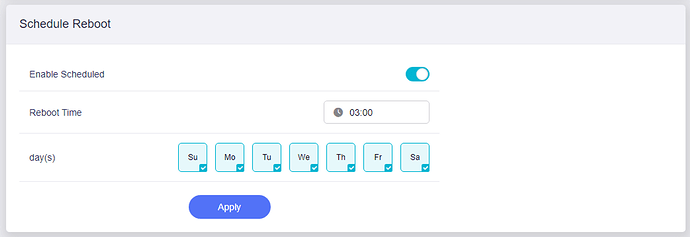

Make sure the Router Time is just correct. If not, you shall go to SYSTEM > Time Zone and select the correct time.
Enable Schedule Reboot, choose the time you want this router to reboot itself and check on the days to perform it in a week. It is recommended to select a mid-night time, since all the clients would disconnect and lose the Internet access when the router reboots.
