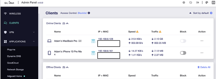

I've enabled Adguard Home on my Beryl AX GL-MT3000. The clients within Adguard are showing either just the IP address or the hostname from the device itself. Is there a way for Adguard home to show the clients by the name I customized in the Clients page within Gl.iNet?
Seems cannot achieve, as the hostnames are recorded in DNSMASQ, AdgH cannot support to read the configuration of DNSMASQ, so you are supposed to issue to AdgH.
In adguard home you can create client setting to make your own list. Make sure your device not randomize mac adress.
Also, double check DHCP server is adguard home, not Router side.
