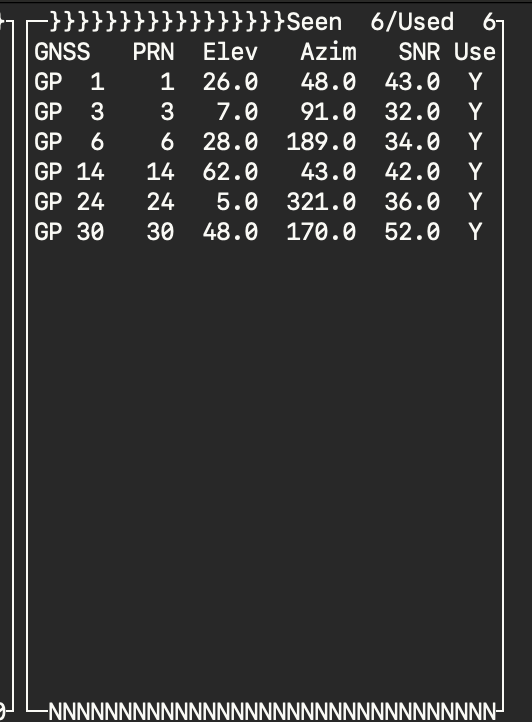

That's all I did and I get the correct coordinates out of cgps, only thing I found confusing is gpsd isn't in the clients package, I had to opkg install gspd.
That being said I only see 6 satellites, seems low, I'm in north Austin and clear line of site today.
I'm using a Peplink MAX antenna that has a dedicated GPS SMA connection which I am not using, I wonder if it's worth it to include a USB to GPS dongle to connect to that...
