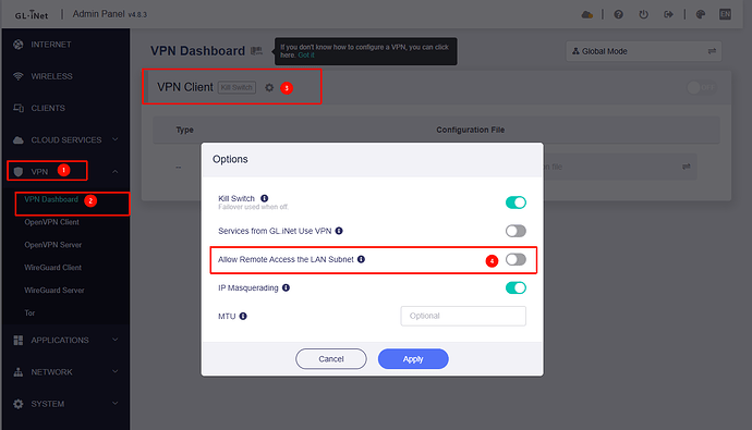

If you want to access the router on the WireGuard client side from the WireGuard server side, you need to enable the following option.
Of course, in essence this is also about adjusting the firewall zones to allow forwarding from WireGuard to LAN.
