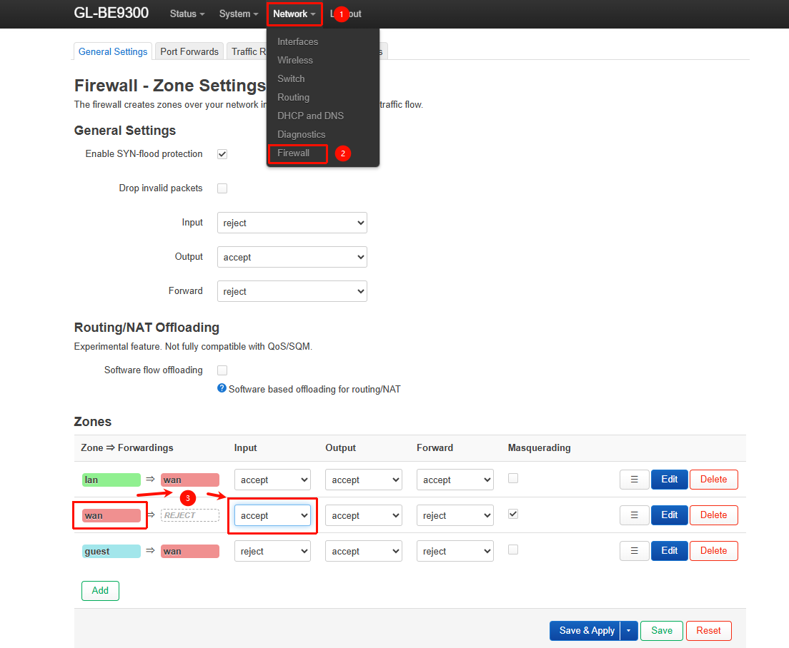

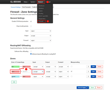

Typically, you’ll need to go to the Pi’s LuCI → Network → Firewall:
(Screenshot from the BE9300 LuCI interface; the FriendlyWrt interface on the Pi should be similar.)
  1. Change the Input setting for the WAN zone to Accept. If you’re not familiar with firewall settings, be aware that this will fully expose the device to the WAN.

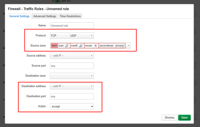

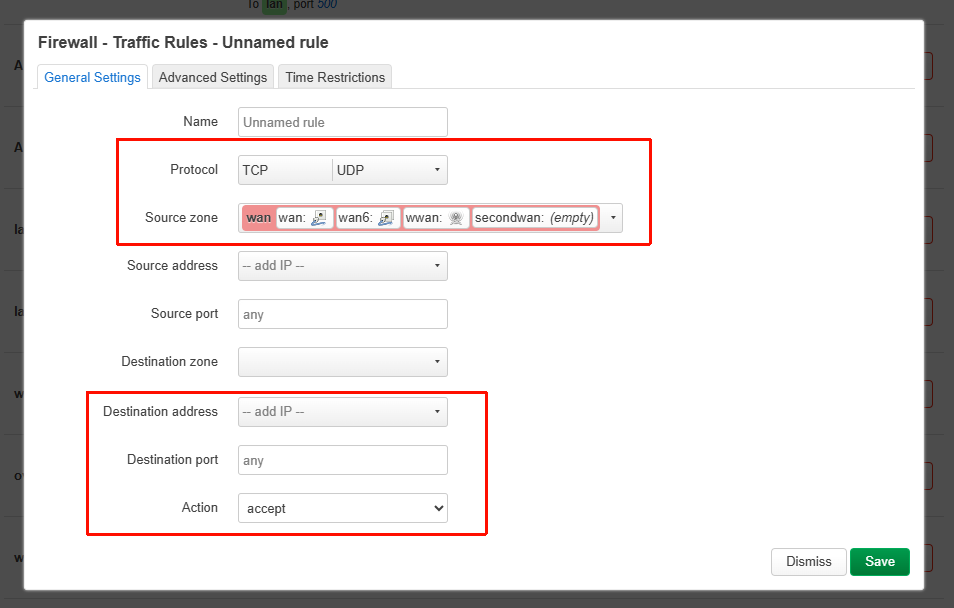

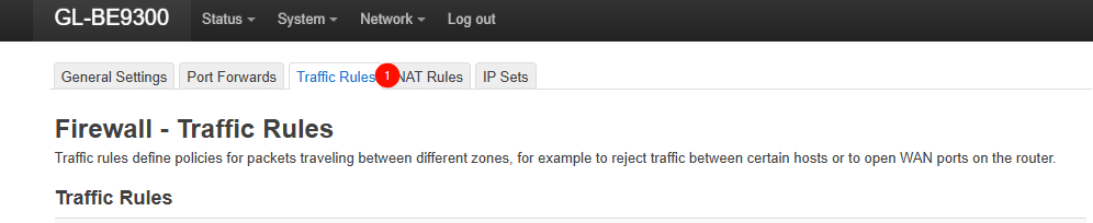

  2. If you only need to open specific ports for accessing the Pi’s web interface or services running in Docker, you can instead create rules in Traffic Rules to open those ports for the WAN zone.
