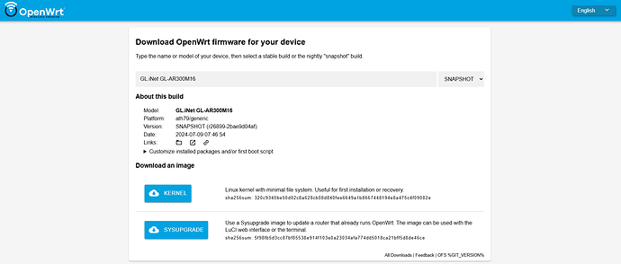

I can't install any firmware AR300m16- ext
I tried using uboot to install the original version, the open wrt version. doesn't work
my version is uboot2.0 version:20.12.24

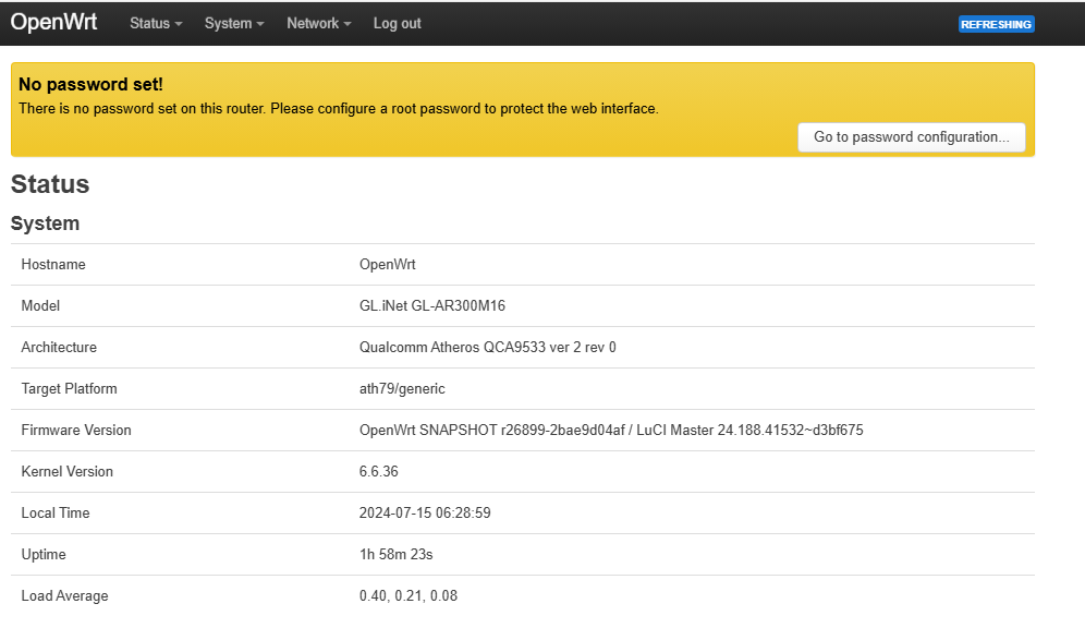

It can install via the GL web or the Uboot, but the firmware did not run any web service for Luci. That is not GL firmware, but OpenWRT.
Please execute these commands in SSH:
opkg update
opkg install luci
opkg install luci-theme-bootstrap
Clip_2024-07-15_14-11-06
