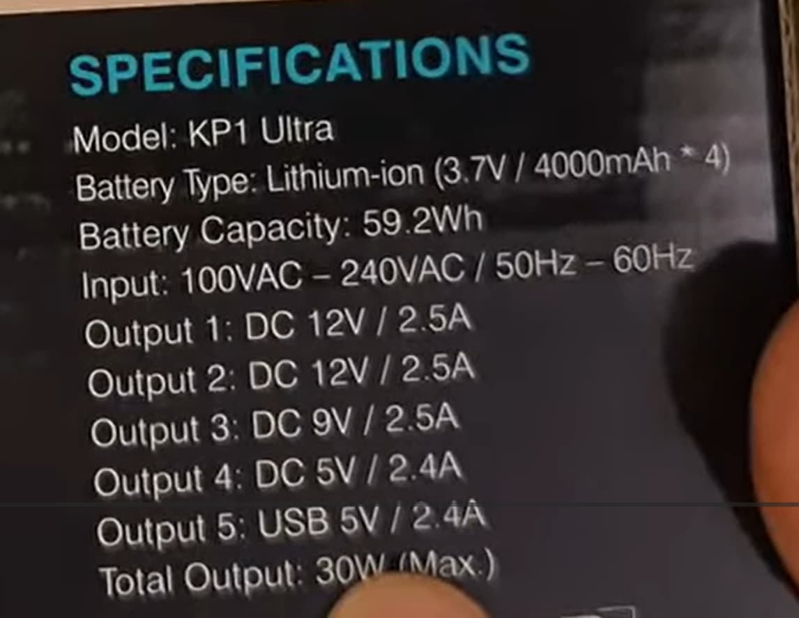

I need UPS for Flint 2
I plan to buy MARSRIVA KP1Ultra.
16000 mAh 30W DC 2x5V/9V/2x12V2.5A
Will the ego be enough to power the Flint 2 without a USB drive?
The Flint 2 specs state :
Power Consumption <20W
And my gut says without anything attached to the USB you’ll be under 10 watts so yes, the KP1 Ultra and easily power this. For how long??, I’ll let someone else do that math.
I would like to hear the opinion of the developers, because it is not without reason that the kit includes a 4A power supply. This router has short-term consumption spikes that can cause a short-term voltage drop.

Sure, if still needs to directly power to Flint2 with the UPS, I think DC 12V/2.5A is enough to power to Flint2 without USB driver, as long as the UPS DC output can reach 12V/2.5A, and the power cable can meet the stable transmission of this power.
