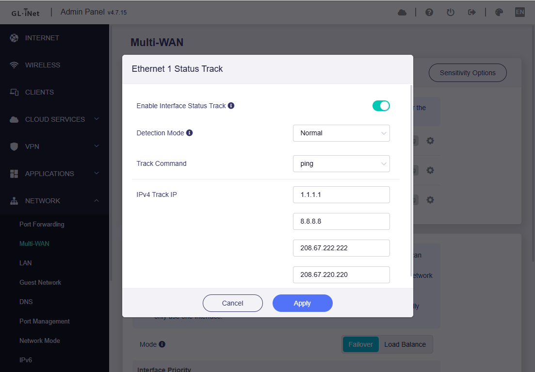

This behavior is related to Multi-WAN, which for detecting whether the Internet connection of the WAN port is available.
This is by design, and it's not a leak.

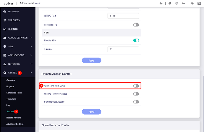

Whether it is a non-public or public IP, if it responds to ICMP, this is related to this setting:
@bruce WRT the screen you showed above, Remote Access Control –> Allow Ping from WAN, these options deal with remote access, presumably from WAN side. The issue I raised has to do with devices on local LAN able to ping the ip address assigned to the gl-inet WAN interface while VPN is enabled. I tested this with the “Allow Ping fro WAN” Enabled and Disabled.
