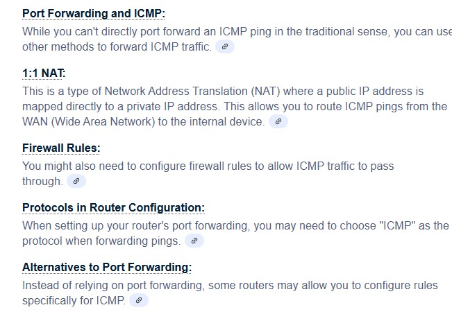

Is there a way to ping a client on the LAN side of a GL-AXT1800 from my system on the WAN side, using some type of Port Forwarding, or 1:1 NATing or some special LuCI firewall setting? I know ICMP doesn't use "ports", but I understand some routers have a mechanism to bounce ICMPs between the two Class C subnets on either side of itself.

Choose Tab "Port Forwards", click the button [Add], and choose as protocol 'ICMP'. Add a rememberable name for the rule and set the internal IP address.
Confirm with the button [Save].
