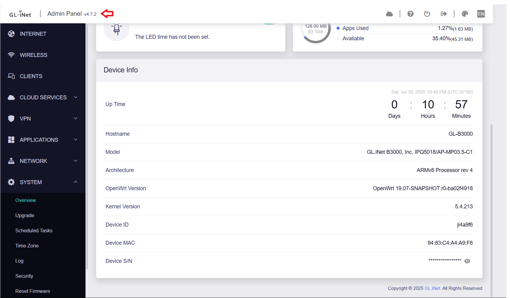

I bought a GL-B3000, which runs OpenWrt 19.07. I want to run a more-recent version, so I installed the beta of version 4.7.2, which I believe to be based on OpenWrt 23.05. But I still see OpenWrt 19.07 when I bring up the Device Info screen.
I've attached a PNG. I see 4.7.2 (to the left of the red arrow), so I think I've successfully installed the beta version. But the OpenWrt version says 19.07, and the kernel version is 5.4, which matches a 19.07 installation. Maybe I've made some mistake, and failed to correctly install the beta?
You are right.
You have successfully installed the GL firmware.
The openwrt version corresponding to V4.7.2 is still 19.07 and has not been upgraded to 23.05.
