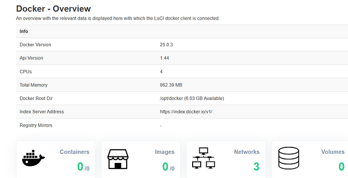

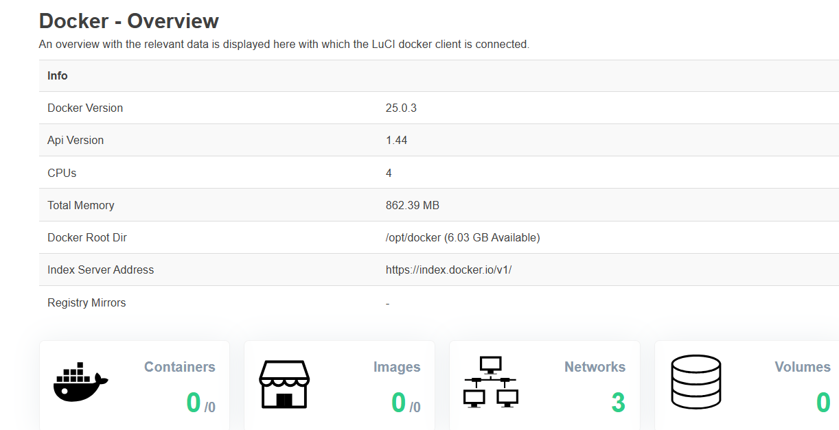

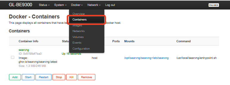

Now I sill have a problem of adding a container- I want to add searxng/searxng:latest but after entering that I get a "bad gateway" error.... I wonder if AdGuard or the content blocking could be the issue?
The “Bad Gateway” error may appear when the LuCI/Dockerman page does not receive a response in time while pulling the Docker image.The image also could be downloadable from SSH, so please use SSH to pull the image and create the container.

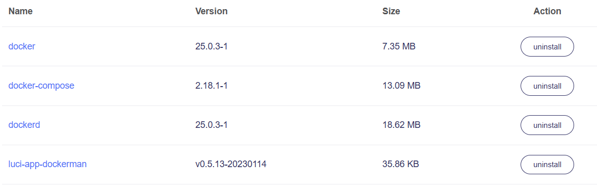

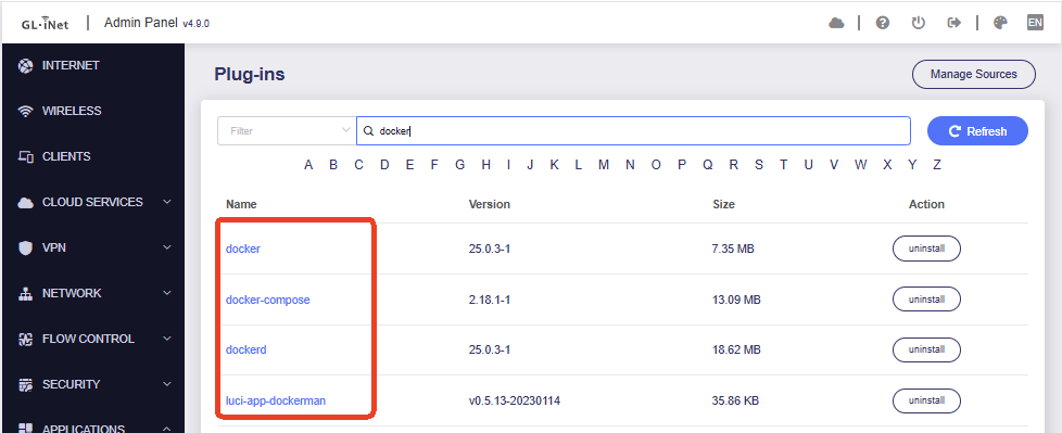

Please first confirm the prerequisite plugins you need to download.
Hey Thanks Charles2, I do have all the docker Apps you list installed. I will try the install from SSH.
Yep have all those installed.
You're a legend,,,,
That worked very well! Thanks so much.

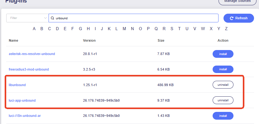

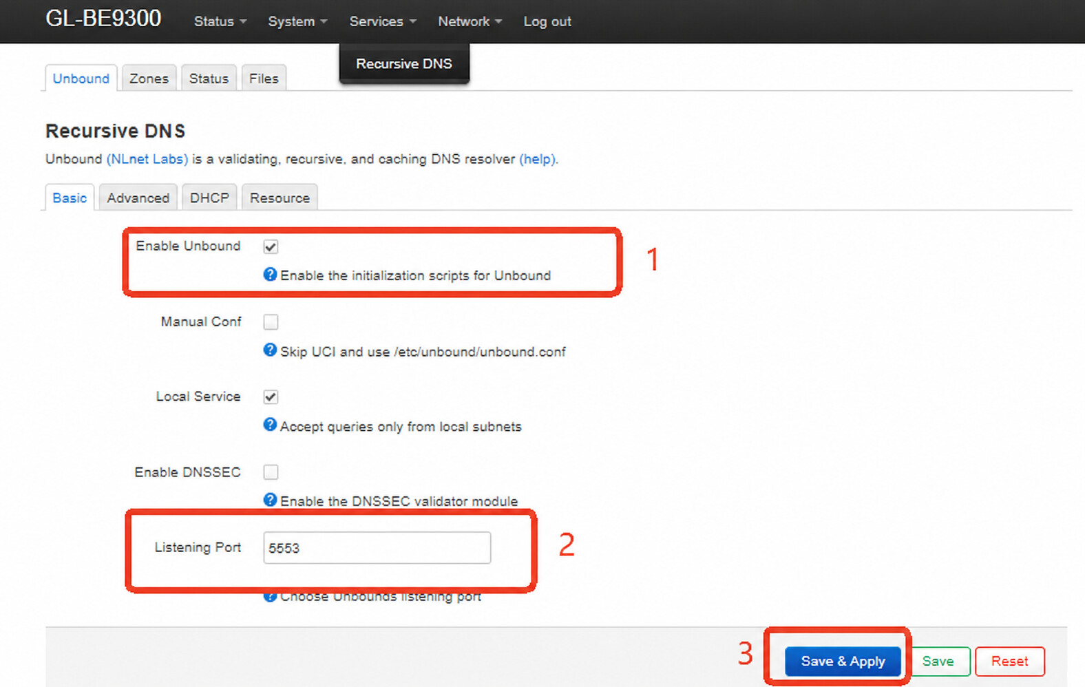

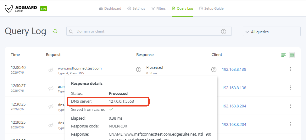

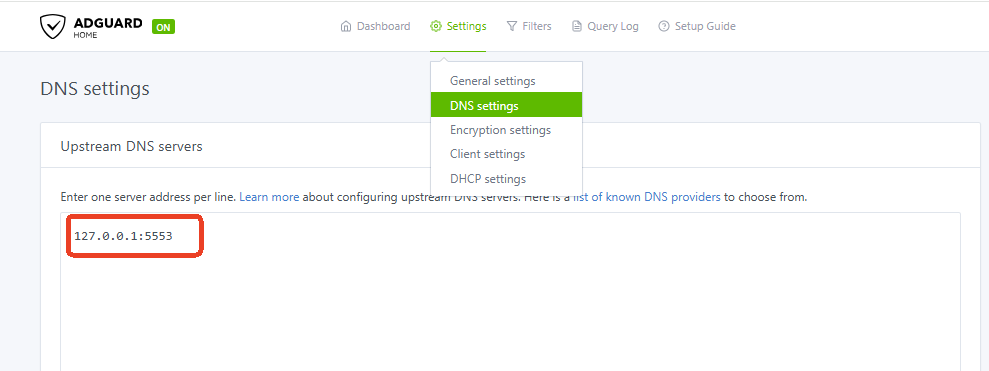

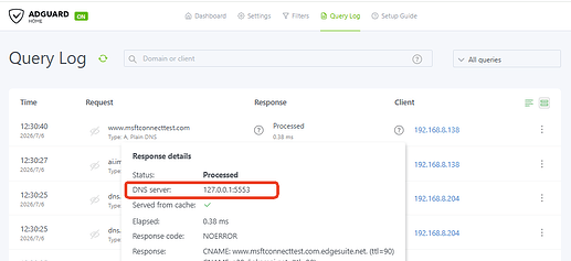

I now just need to get unbound working for AdGuard - I have installed some sort of unbound but I am not convinced it is being used. (I do have AdGuard + Unbound running on a RasPi 5)

Thanks Again Charles 2 - your legendary status continues. That was simple enough....

I did find the Unbound Apps/plugin in the past but there are so many I was unsure just which one to use and then how to properly configure it with the correct port - or can it be any port other than 53 or 5353 or 3053 as the Adguard setup tab shows - there might be some other port numbers I have seen elsewhere.
