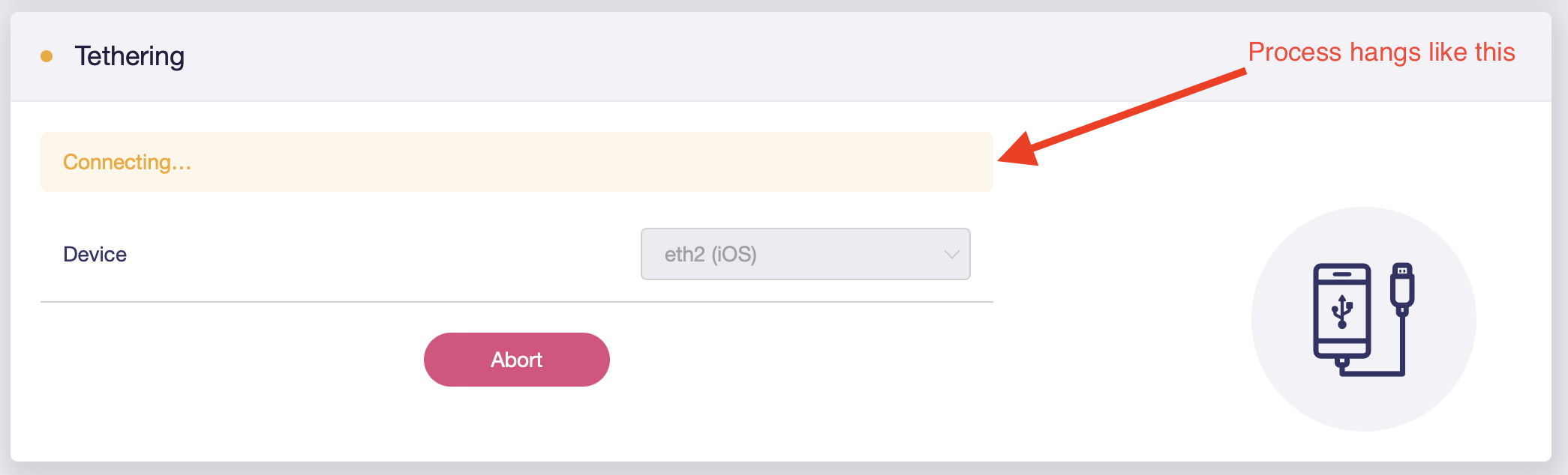

I’m able to use repeater and 4G connections easily with my new GL-X3000 but somehow fail to tether using my iPhone 11 Pro with iOS version 17.1 and router software version 4.0 and 0405release1.
I did factory reset for the router just in case before trying this.
I read elsewhere from this forum that I need to first disable bluetooth and wifi and the iPhone tethering fail docs mentioned that I need to use the Maximise Compatibility mode.
I disabled the bluetooth and wifi and enabled hotspot only in the USB mode.
I then was prompted if I want to trust this computer on my iPhone and I entered my passcode there to do so.
I check that my iPhone has 2/4 bars of 4G available and the mobile connection is working. I can succesfully also use the tethering with my MacBook.
When I click connect on the admin dashboard of the router it will get stuck into the connecting phase:
I think these are the relevant logs from my router:

Logs look good so far, I would say.
Did you restart your iPhone?
I’ll try update the iOS to latest 17.2.1 version and it will then restart as well.
I waited for 10 minutes first time and retried and waited for 5min then.
I guess that timespan should be enough for the router to connect?

Hmmm after I plugged my iPhone and it was connecting I visited the advanced settings and the Network->interfaces the router mentioned that it will migrate the settings to LuCI or something like this and after that the tethering started to work :man_shrugging:
The ways in which the GL GUI interacts with OpenWrt are unfathomable. :smile:
I tried again with my iPhone 11 Pro with iOS 17.2.1 and it works perfectly. No need to for example trust the router again. Just plug&play.
But when I tried with my partners iPhone 13 Pro with iOS 17.0.1 it didn’t still work so I guess the new iOS might have been the trick as well.
I’ll try to update that as well and hopefully it works.
