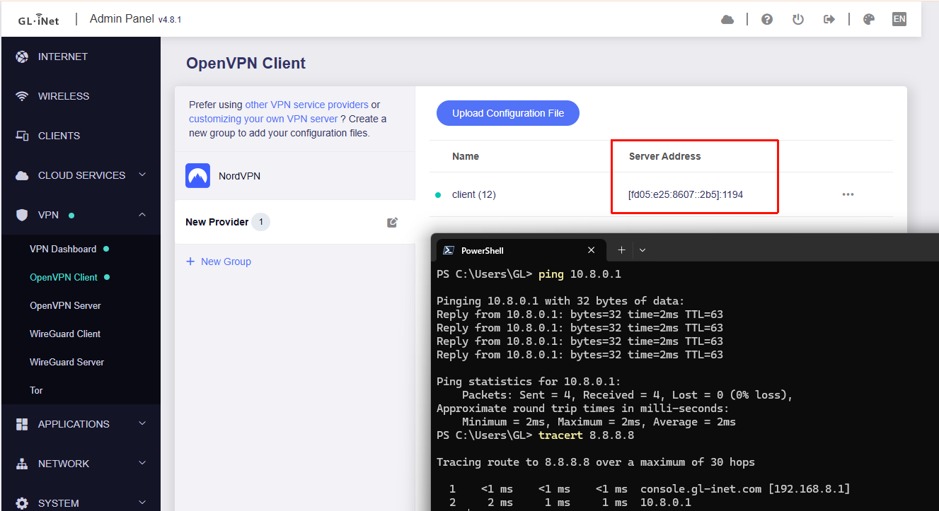

We have tested this locally using MT3000 v4.8.1 and were unable to reproduce the issue. OpenVPN Client using IPv6 as the server address are able to establish connections and transmit data normally.

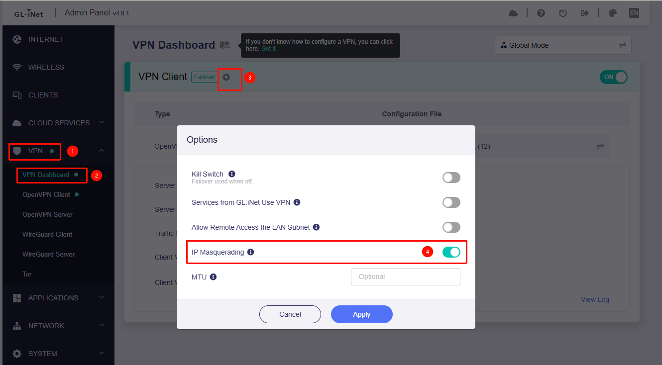

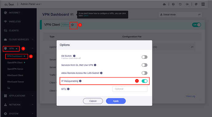

Logs: If the issue persists even after enabling masquerading, please export the device logs and send them to us via private message for further investigation.
