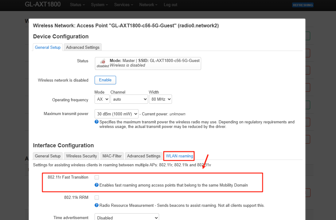

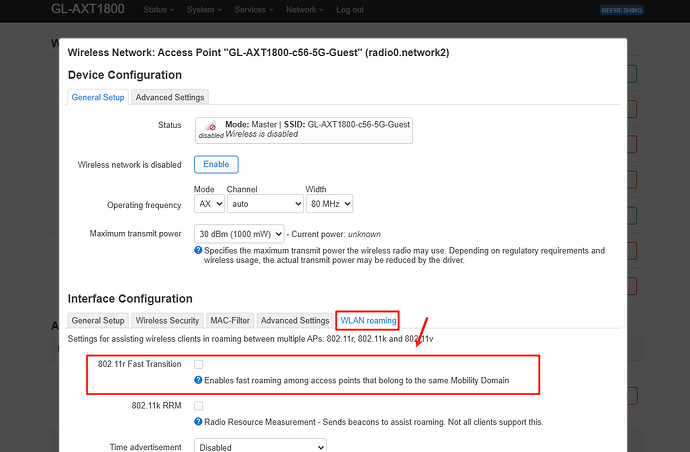

Currently, mesh networking is not supported.
As an alternative, you can enable 802.11k/v/r to improve roaming performance between access points, while 802.11k and 802.11v are enabled by default.
To enable 802.11r, open LuCI > Network > Wireless, click Edit next to the target SSID, and enable 802.11r Fast Transition in the WLAN Roaming section.
Please note that the Beryl AX requires the OpenWrt 24 (op24) firmware for 802.11r support. The firmware can be downloaded from:
