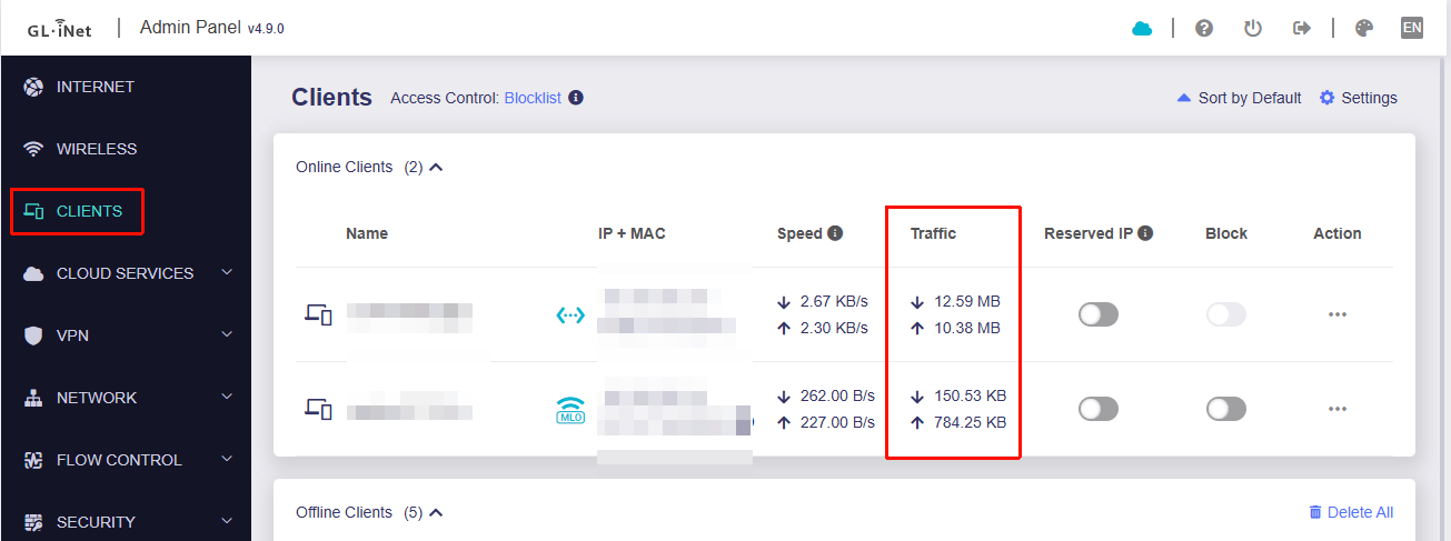

You can view the traffic usage of each device in Admin Panel → Clients.
Please note the following about this feature:
  1. You need to disable Network Acceleration under Network → Network Acceleration, otherwise the data may not be accurate.
  2. Devices using both Wi-Fi and Ethernet will appear as separate entries (since they have different MAC addresses).
  3. Devices connected through a switch attached to the router will also be displayed here.
As for accuracy, there may be slight discrepancies, but it should be reasonably close. You can try downloading a 100 MB or 1 GB file to verify.
(In our local test, downloading a 105 MB file showed about 107 MB usage, which is reasonable considering overhead from HTTPS and other protocols.)
