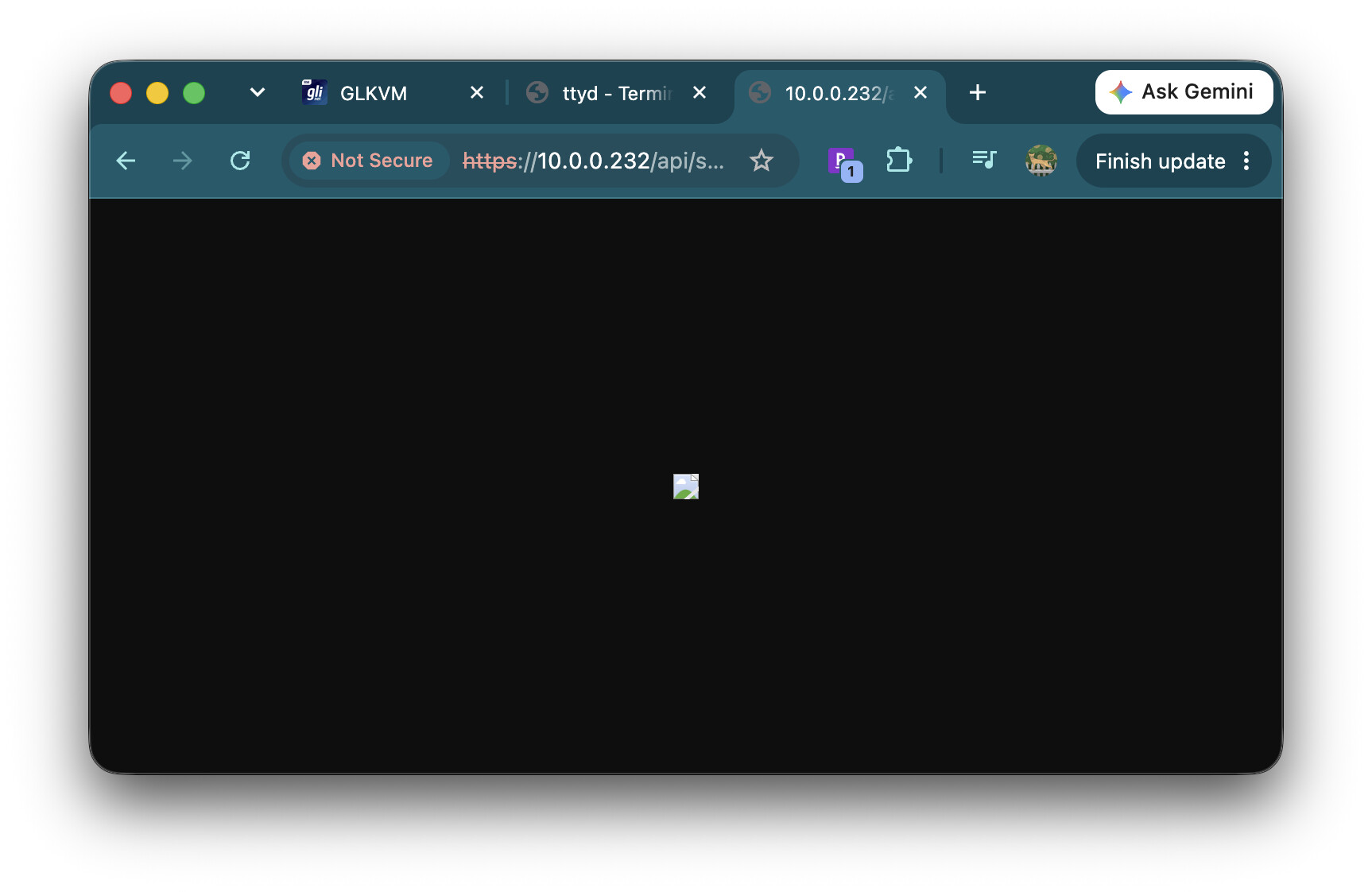

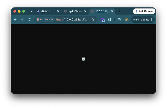

Hi @minmie I have one RM1PE(v1.10 beta) and one RMQ1(v1.8.3). The snapshot API works fine on RM1PE but it fails to load on RMQ1. I’m sure the machine is connected and active on RMQ1 as I can control it. Is there a way to debug what might be wrong with this API? I can’t find anything in the logfile /userdata/log/kvmd.log
I'm sure other products definitely support this API. As for RMQ1... maybe we can hope they fix the bugs. But this product seems to have very limited hardware resources, and I'm not sure if it can support it.
Let’s give it a try! I did some digging on why it fails for RMQ1 and here’s my post of the bug report. I also posted a workaround. It seems ustreamer-dump --sink kvmd::ustreamer::h264 --count 1 --output /tmp/frame.h264 works fine for getting one frame from the stream.
