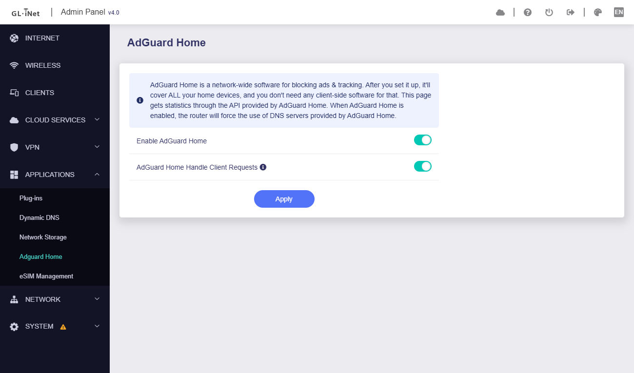

Hi, I am currently testing beta firmware 4.7.2 with my XE300 (Puli). Installed gl-sdk4-ui-adguardhome together with gl-sdk4-adguardhome from the Plug-ins section. Issue:
I am unable to start and stop Adguard from the GUI. The button "Enable AdGuard Home" is locked - means it does not move in either direction.

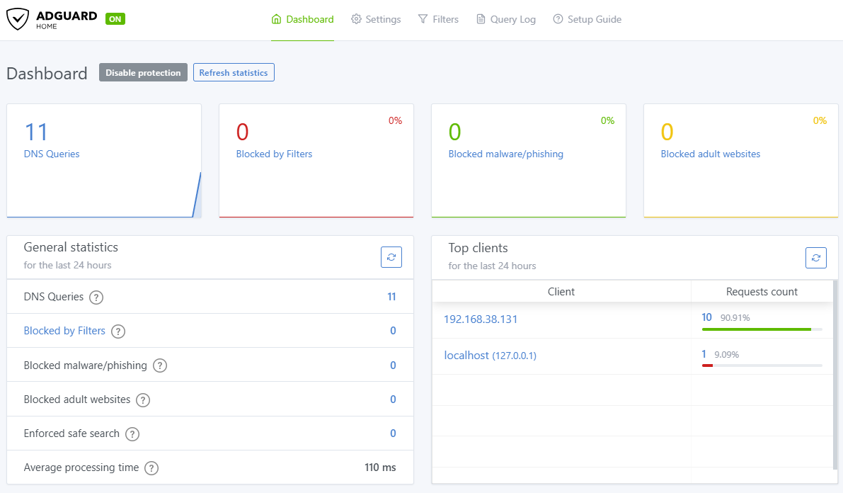

Also statistics are not updated in the GUI when Adguard is running.

ADG can be enabled in GL GUI and seems to be no issue to run, but there is indeed an issue about statistics in GL GUI.

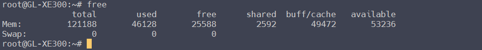

When ADG is enabled, the RAM usage is very high, as well as the CPU, and the system response has obvious lag. For example, the ADG setting page is opened slowly.

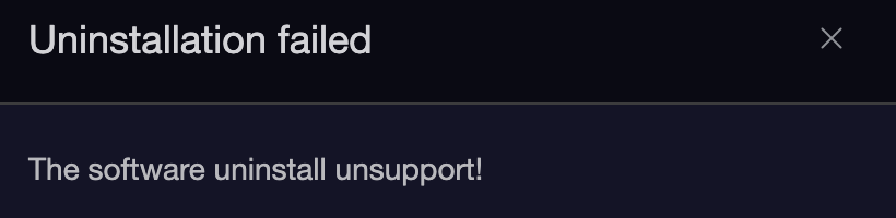

One last question: Would you know how to uninstall Adguard. When I try from the GUI I get below message:
Is there another possibility without reseting the complete router install?
Regards Jan
The relevant ADG plug-in package can be removed in the router SSH:
opkg remove gl-sdk4-adguardhome gl-sdk4-ui-adguardhome
