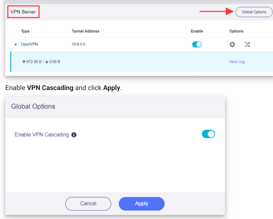

On firmware 4.8, the VPN cascading option is no longer available in the UI.
But the VPN cascading is still avialable.
Please refer to the following documentation for configuration guidance:

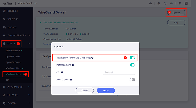

Also, make sure to enable “Allow Remote Access to the LAN Subnet” on the WireGuard server if you need access to your home server.
