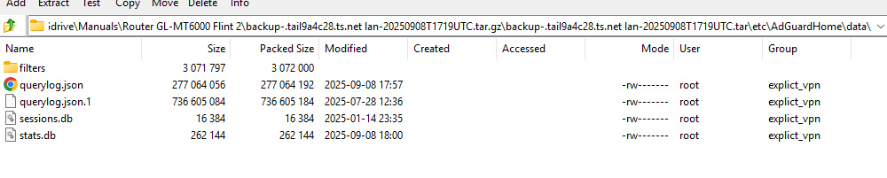

this adguard folder is very large !
Huh; I don't use AGH so I wouldn't know. If you edit /etc/sysupgrade.conf look for any reference to its dirs there. I'd probably just remove its entry to instead carefully curate a list of specific AGH-related conf files to keep just for the proper operation of AGH. Query log & stats wouldn't be ones I'd bother with, for example but there may be more.
