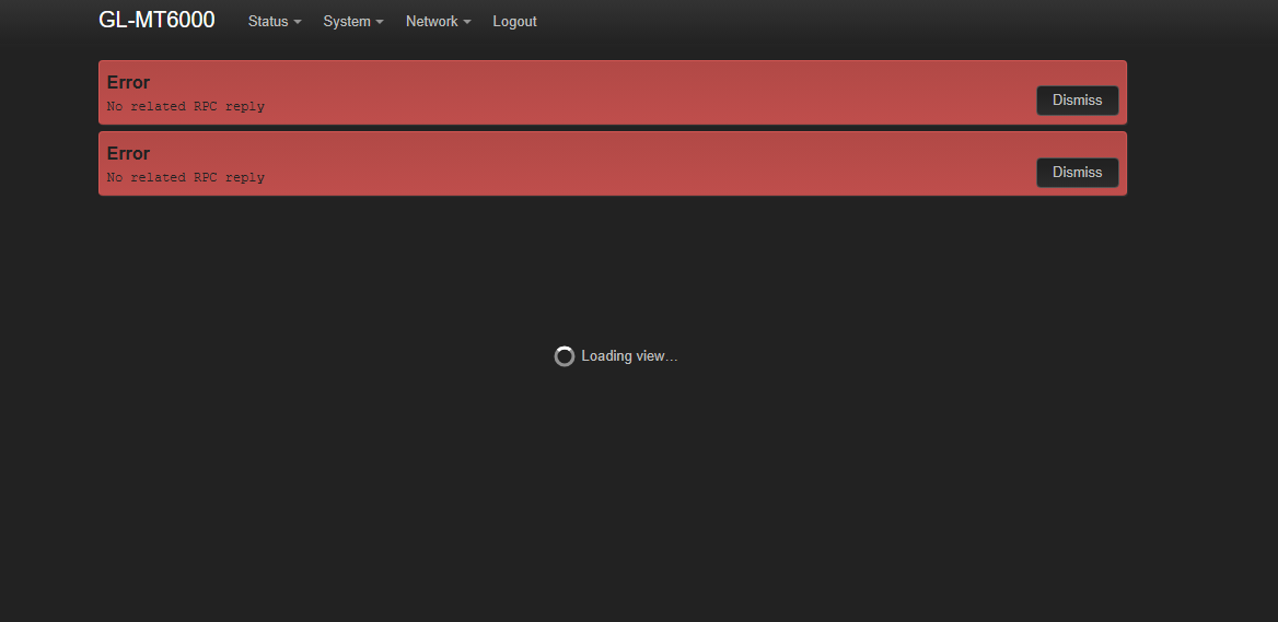

Issue setting up SQM on Flint 2
I am having issues setting up SQM on my Flint 2. Whenever i login i get this error you can see in the screenshot and another one of them pops up when i go on the SQM QoS page. The page also just loads forever, nothing ever shows up apart from this 'loading views' text. This is my first time getting a router not provided by my ISP and i really dont know much about networking or routers. Im just trying to improve my bufferbloat and latency for gaming.
Could anyone please help me figure out what my issue is as i really dont even know where to start?

Thanks for your reply, i actually tried all these things before posting and nothing worked! I have had to downgrade my firmware version and now it works and im able to configure sqm.
Starting foom 4.7.0, you have to use a separate port to access LuCI.
