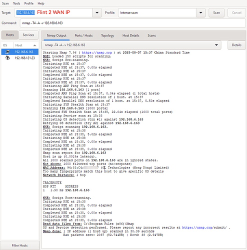

Is the public IP on Flint2? How did you scan to these ports?
Flint 2 with v4.8.0-op24, there is not any opened ports in scan
