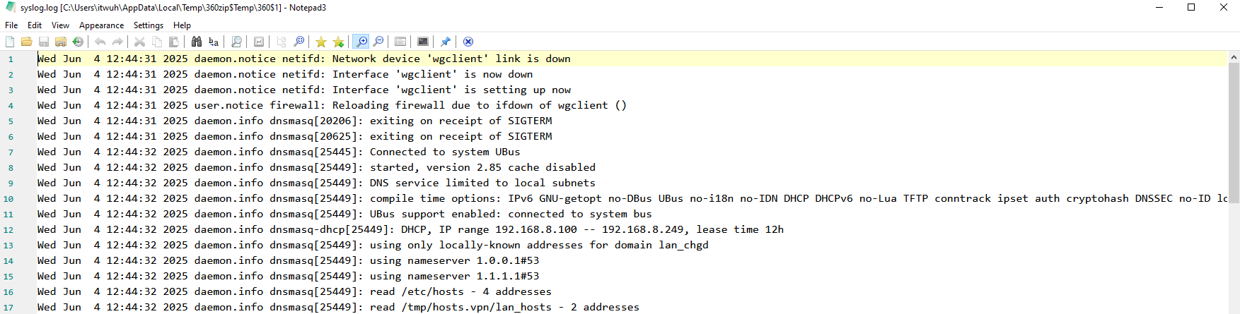

The 2 syslog you sent, we did not find the WireGuard VPN client issue, just only saw the

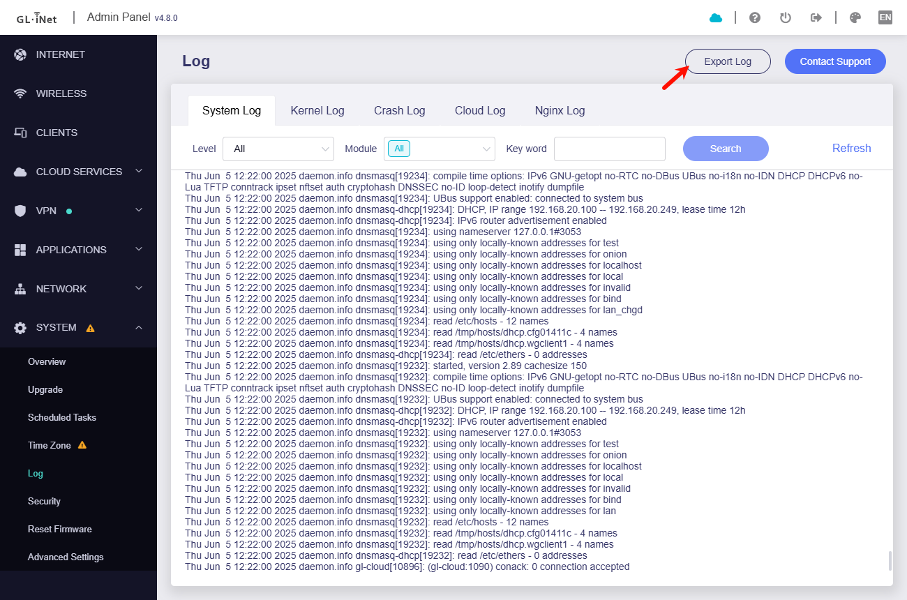

Please export the syslog from GL GUI > System > Log > Export Log for export the entire log
