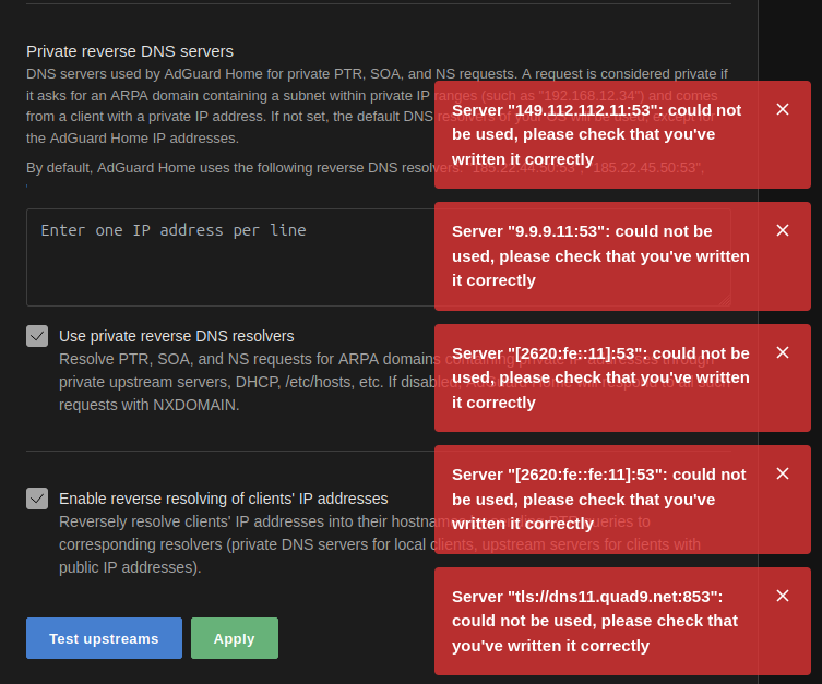

I have the issue, that if I connect to my parents network with Wireguard, I can’t setup the AdGuard DNS anymore (see last picture)
If I disable the Wireguard connection, AdGuard has no issues with the DNS…

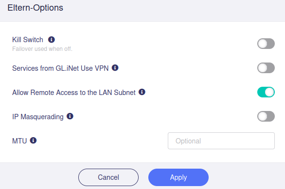

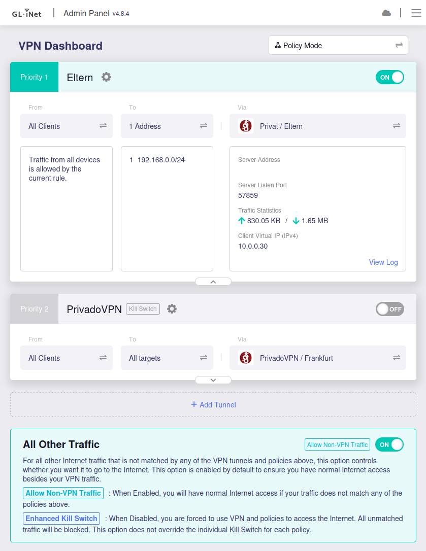

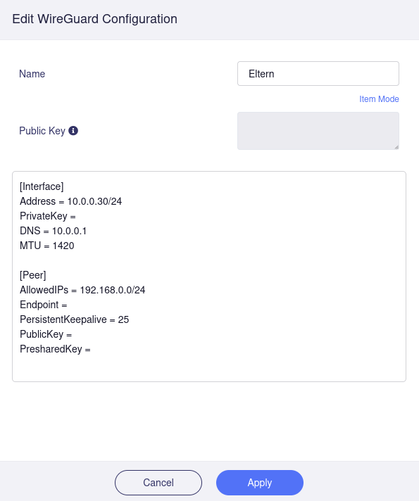

Here is my setup:
Am I missing something?
