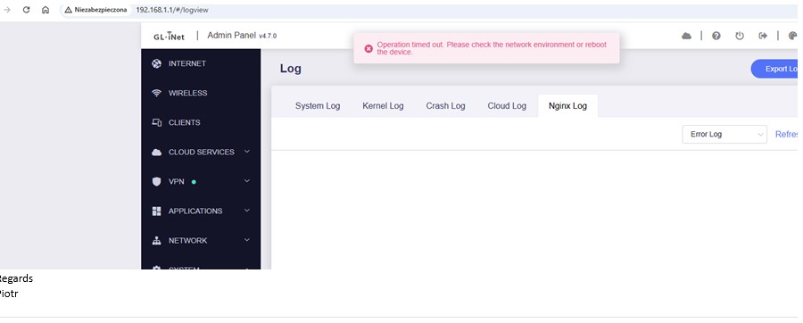

Regarding users with Flint 1 with v4.7.0 WAN or LAN port abnormality, R&D has guessed this possibility, if you are the users who encounter this abnormal, please help verify.
Will there be any improvement after disable the network port eee save energy?
SSH to the router, and execute the commands:
ethtool --set-eee eth1 eee off
ethtool --set-eee eth0 eee off
R&D and I did not reproduce the WAN port issue "down -> up" local Flint1 (s), and running for about 24 hours.
TIA!

All of them
Below is the ping result from a device connected via Ethernet cable.
The router simply becomes unreachable

What is the MAC of this device that performs ping?
We did not find any exceptions in the syslogs, and the DHCP renewal of all clients is normal.
Could you please share the router with us via GoodCloud, and PM me the router MAC and the Web UI login password.

Hello all,
Regarding the network port issue, is this issue improved with these commands?
bruce:
