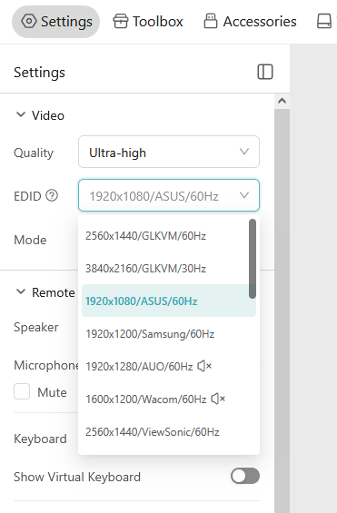

We provide modification through the WEB UI, which is more convenient than the command-line method.
But it's worth mentioning that many pikvm commands don't work on GLKVM, such as the edidconf you mentioned.
Is there any alternative to edidconf? Does GLKVM web ui support it?
UI support
Great!!! So that will replace the monitor name.

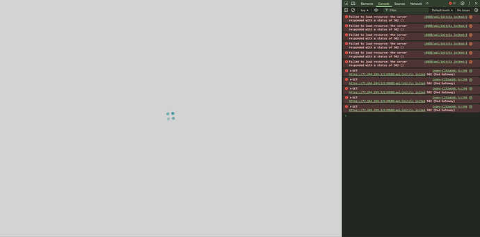

After that change, I cannot access to GLKVM web or terminal
Is there any way to fix it?
All modifications to /etc/kvmd/override.yaml must comply with the Yaml format.
You can use the kvmd -m command to see the specific indentation required for writing the configuration.
If you write incorrect configurations, the program will terminate during initialization due to a failure to read the configurations.

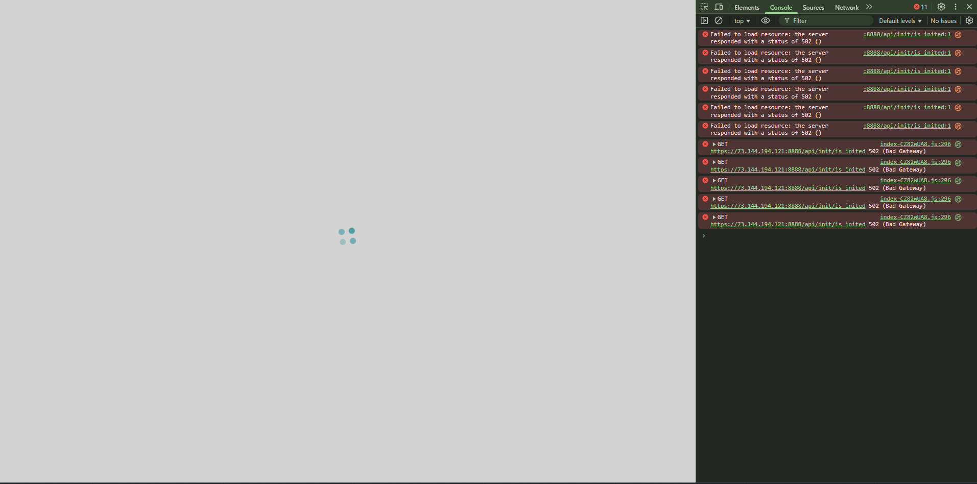

After that, I cannot access web ui or terminal. Just loading inifinitely
This editor doesn't allow the whitespace at the beginning of the line. The indentation was correct.
Please refer the screenshot
Your FPS configuration is incorrect, and COMET cannot be configured for FPS by this way.

I think so. But I can't access the ui, and it doesn't let me update the config.
You can SSH in to make changes. The username is root. Alternatively, hold down the button until the LED flashes blue rapidly, which will reset device.
SSH works. Thank you for your support.
