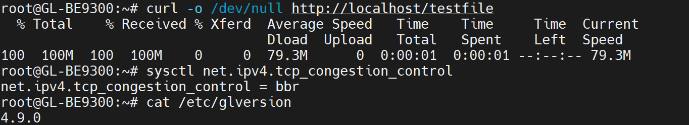

How to check if you are affected
With BBR active, from the router:
curl -o /dev/null http://127.0.0.1/<some large local file>
Healthy: hundreds of MB/s. Broken: tens of KB/s.

Confirmed working — I've been running it since August 8, about 11 days, on 4.9.0 / kernel 5.4.213. cwnd behaves correctly, the module unloads cleanly, and the Web UI / loopback problem is gone. Good to publish.
