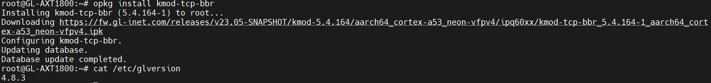

Please try the following:
kmod-tcp-bbr_5.4.164-1_aarch64_cortex-a53_neon-vfpv4.ipk (5.9 KB)
It works for me
Admin-provided IPK (5.4.164-1, neon-vfpv4) installed Jun 28 2026. Required
adding arch aarch64_cortex-a53_neon-vfpv4 to opkg.conf — GL.iNet ships with
only aarch64_cortex-a53 configured. opkg install created /etc/modules.d/tcp-bbr
and /etc/sysctl.d/12-tcp-bbr.conf; sysctl.conf updated for persistence.
sch_fq absent from kernel — fq_codel retained as qdisc. Tunnel verified
post-install

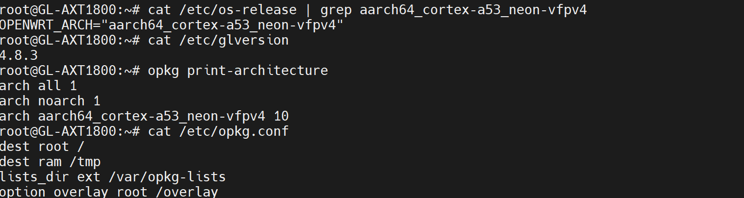

Also, the AXT1800 should normally use the aarch64_cortex-a53_neon-vfpv4 architecture. I'm not sure why yours is reporting aarch64_cortex-a53 instead.
In any case, we're glad to hear that everything is working as expected.
Confirmed working here as well.
Also confirmed our AXT1800 is using the neon-vfpv4 architecture by default.
Thank you for confirming.
The kmod-tcp-bbr package has now been added to the repository and is available for installation via OPKG.
