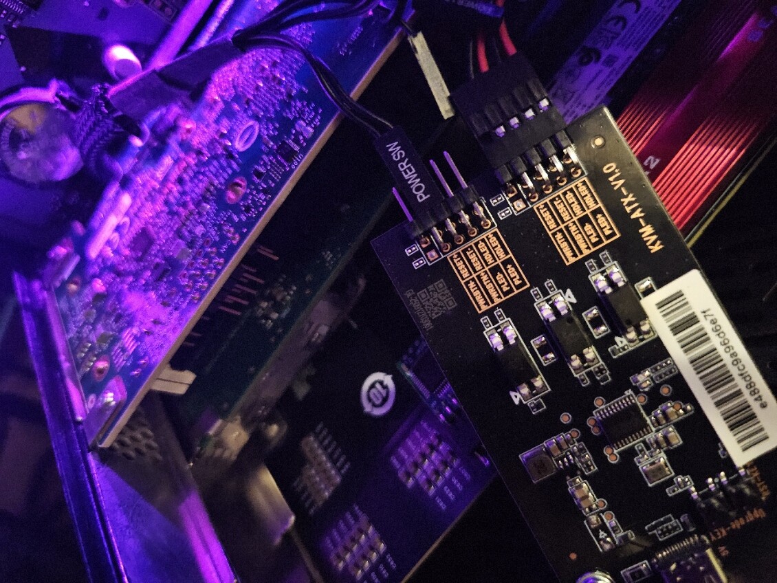

Hi I have an issue regarding my KVM ATX board where I am unable to turn on my system remotely using the KVM ATX Board from the Web Interface.
Powering on using the physical PC Power Switch works in my case

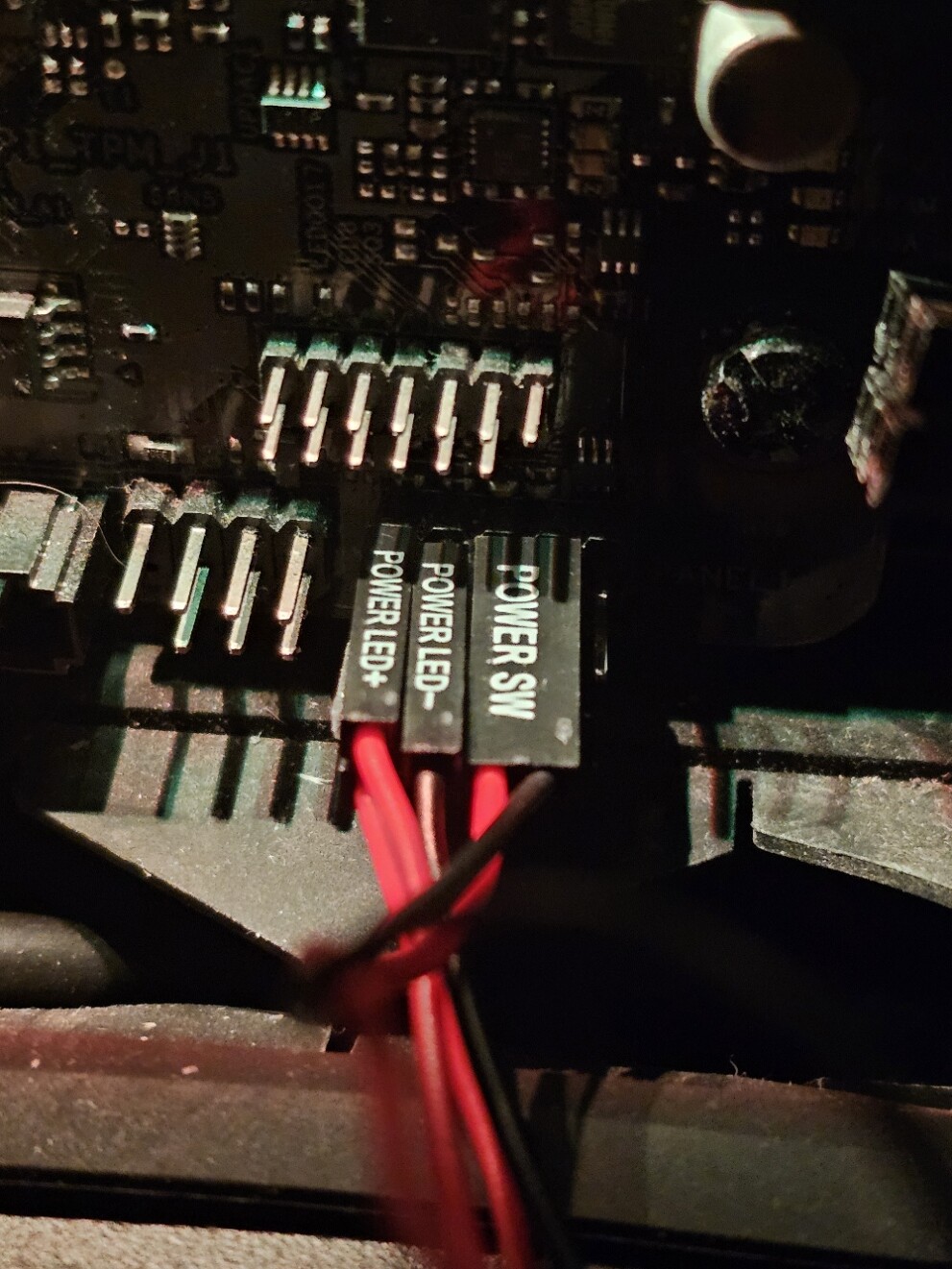

I have followed the suggestions said by many in other threads such as flipping the POWER SW switch at the motherboard side but still I am unable to power on the system.

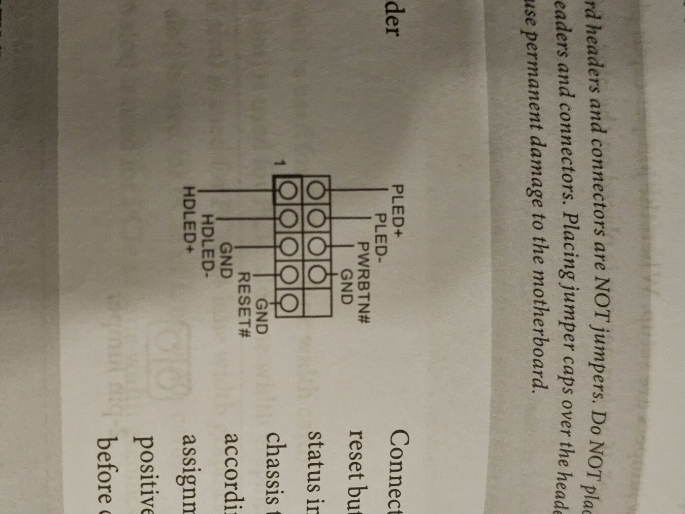

System is an Asrock Z690 Pro RS in a Fractal Design R5 Chassis.
Hoping to get some help regarding this issue here. Thanks in advance for all the help.
It seems there's a connection error on your ATX motherboard. Please refer to the image below.
Hi I rewired according to your diagram and I am still unable to remotely power on the system. The ATX light is on
Using this doesn’t help
