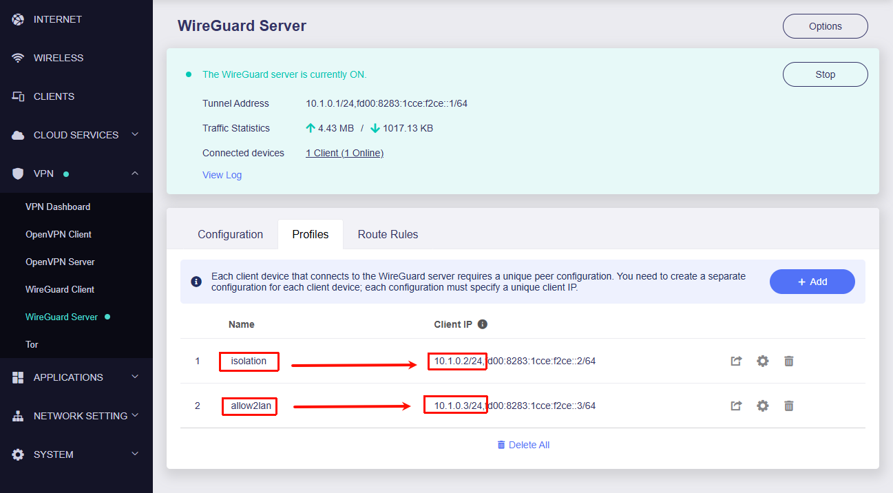

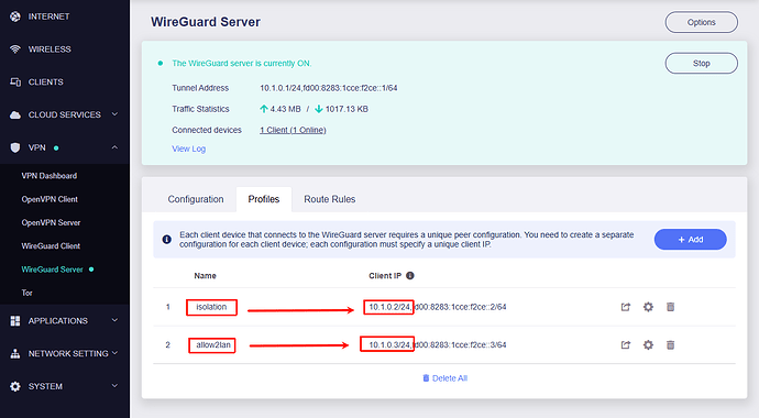

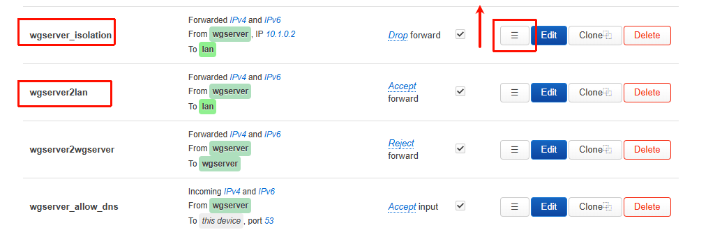

Please try to create different WireGuard profiles,

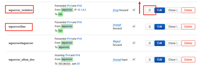

then go to LuCI - Network - Firewall - Traffic Rules and create the following rules for the WireGuard IPs that need to be isolated from the LAN:
Note that you need to drag this rule above wgserver2lan.

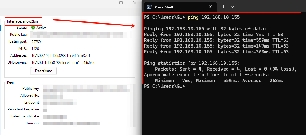

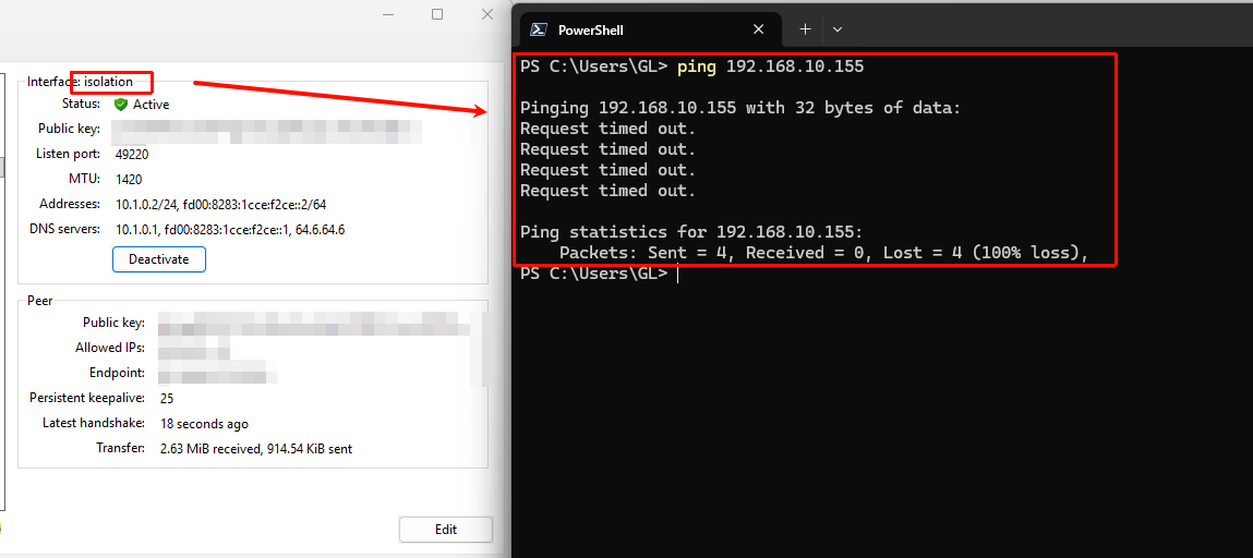

Results:
isolation:
allow2lan:

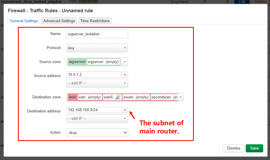

I have tried your solution with firewall rules and it did not work.
I have tried different settings, finally it worked when I set destination zone as WAN.
I hesitate to change zone definitions on my own.
Could you tell me which way is better - properly define zones and in this case I would ask you to help me with it, or leave zones as is and just use firewall rules which I found to be working?
The firewall rules we provided earlier were based on the MT2500 being used as the home main router, with LAN devices connected to its LAN ports.
Yes—if the MT2500 is used as a secondary router and the LAN devices are connected to the LAN ports of the upstream main router, then the firewall rules should be adjusted accordingly:
  • Set the destination zone to WAN
  • Set the destination address to the subnet of the main router (TD-W9970)
    (If this is left empty, this WireGuard client will not be able to access the Internet.)
