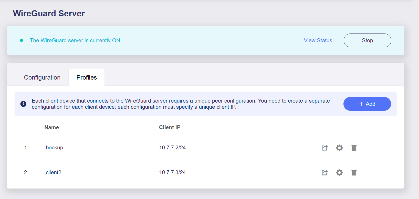

first you need to look to your wireguard peers on the server on site A router, by default it shows as:

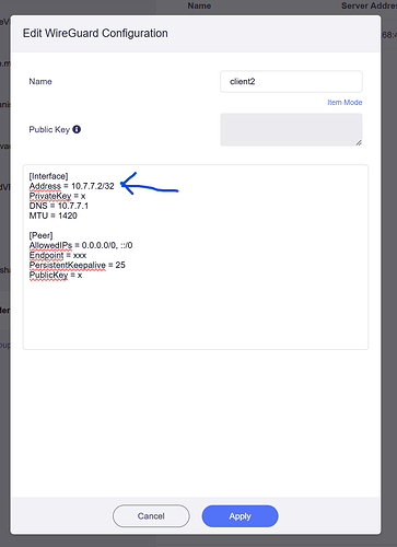

Do you see the /24 this needs to be set to /32. unless you want peer to communicate to each other, in your case you probably have only 1 peer (site B), this is fine but the clients need to have some configuration changed.
please do so on site B router by editing the vpn client:

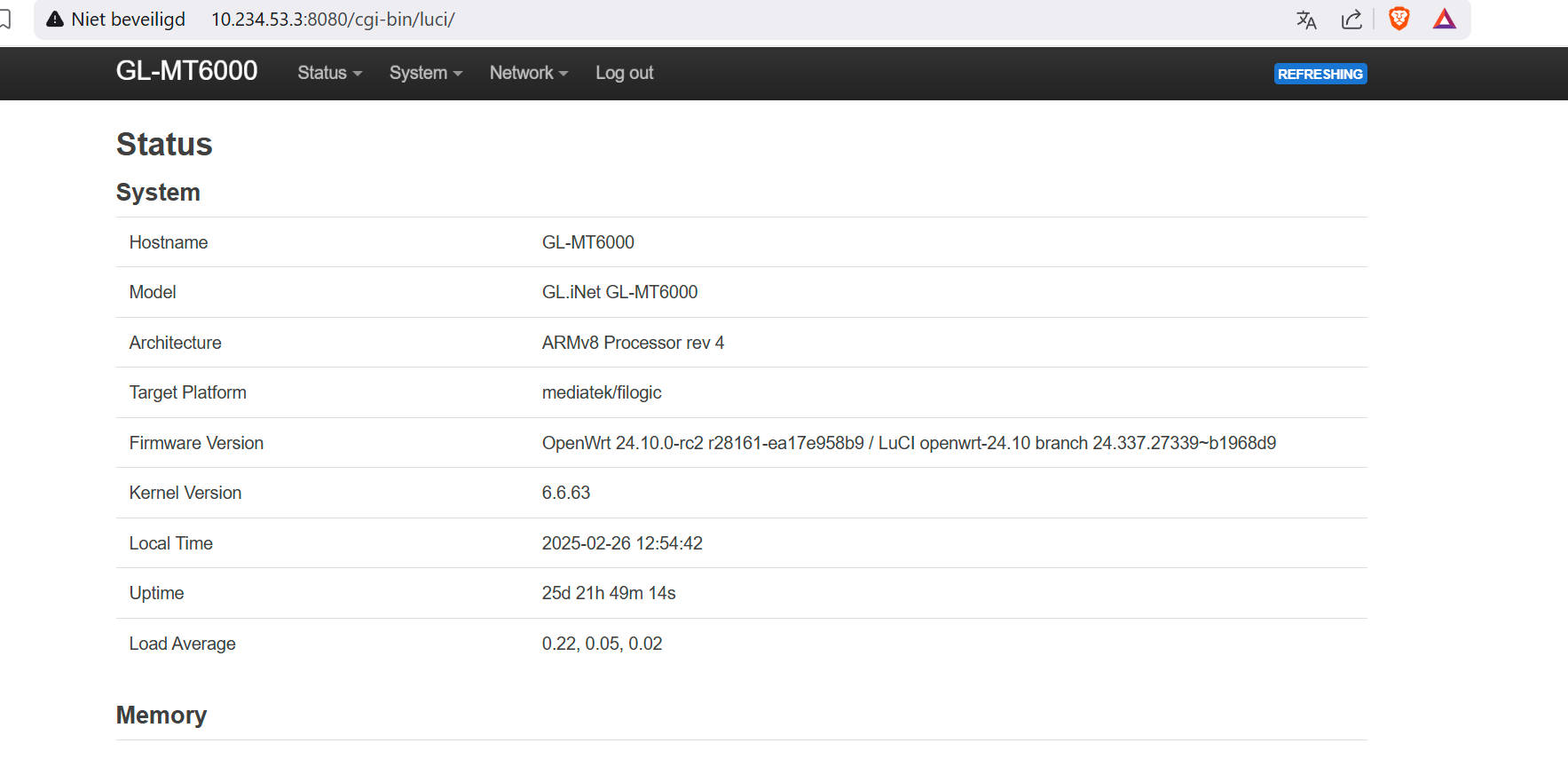

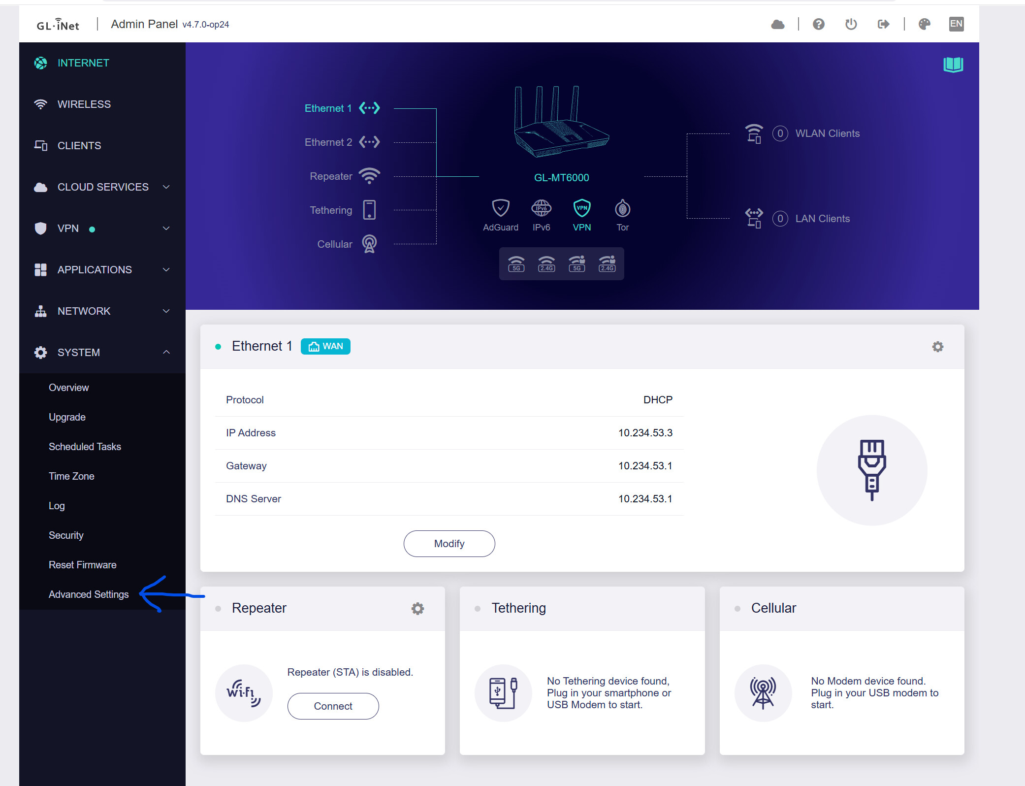

if you navigate to here please for site A (the server with tv):
login with root user and password same as ui.
you will see this or similar:

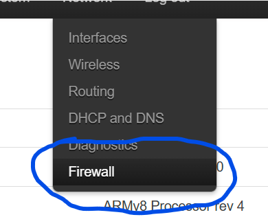

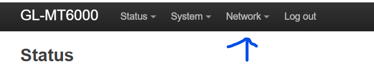

click on the navigation here:
then here:

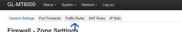

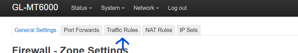

then you click on traffic rules tab.

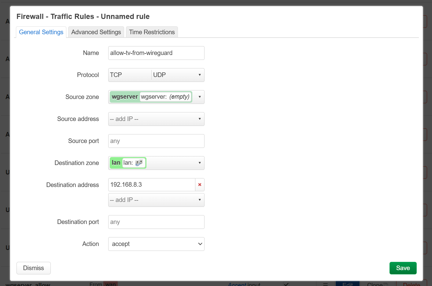

now create a rule as following:
make sure that your tv device is running on this 192.168.8.3 ip this is very important you need to have to set this to static, you can do that via the router but you can probably also do that on the device it self via manual network configuration.
if you know the ports for the destination you could theoretically set this in your rule this will lock it down more which is securer although the vpn layer makes it very secure compared if you would do it via wan so not a big issue can always be used to improve later on.

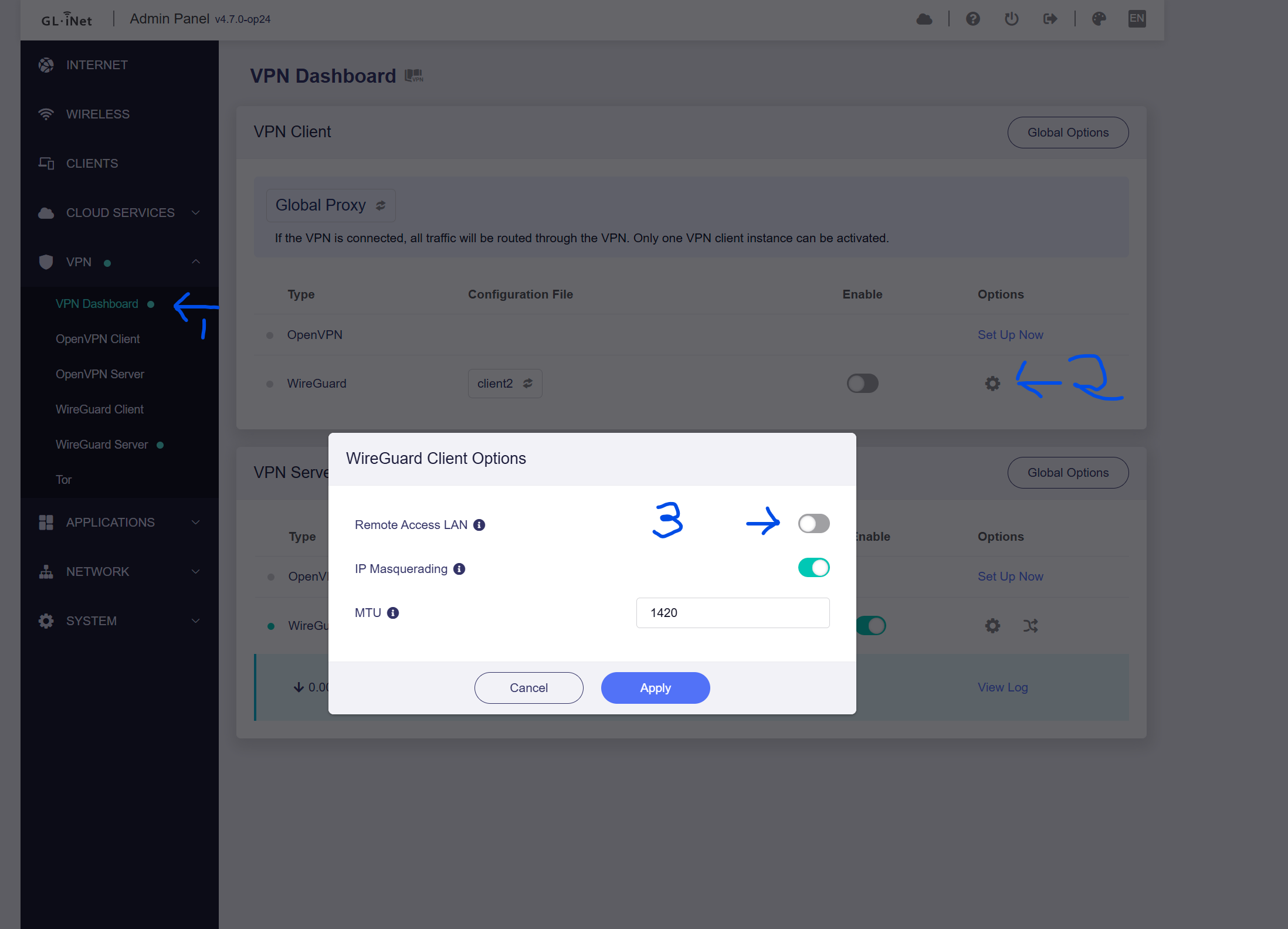

make sure on site B you have this option checked:
