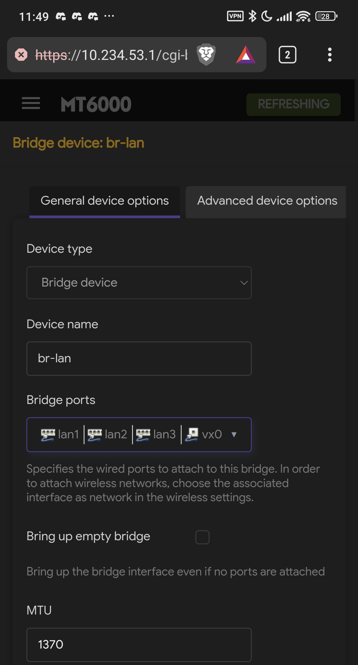

Wireguard is very simple, and using luci-proto-vxlan works also very nice, you only need some knowledge how to configurate it with DSA but if you get it, its much easier.
Heres some screenshots:
the vxlan interface:
I point the tunnel addresses to each other.
And here i vlan tag it on br-lan see vlan 50:
and here the bridge device itself:
