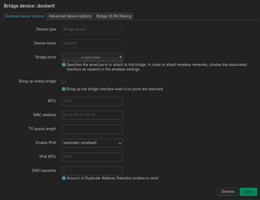

Right, I found the network:
When I open docker0 device I get this:
Is that OK?
That is the correct one.
For the docker0 you can leave this one alone, this is only for containers on the main subnet, only docker containers with their own network generate these bridge devices.
Now you can create a new interface with protocol unmanaged and select br-3f50… then you only have to assign a new firewall zone, and then edit the firewall zone to forward to wan.
Also its wise to check the checkbox keep up bridge/bring up empty bridge in your screenshot.:+1:
this veth device gets automaticly generated and hooks into the bridge, but docker is unaware that the bridge can also go down and fails adding it, this solves the issue because docker expects it to be forever up.
If all is right configurated and no internet, you may need to reboot the full device.
